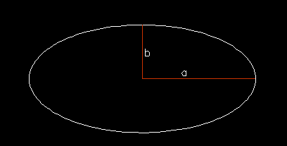

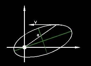

A satellite of mass m rotates in a circle of radius a round a star of mass M.
At point P it's velocity V0 is altered to be parallel to the x axis.
The trajectory becomes an ellipse. show that the axes of the ellipse are a and b.

What i don't understand is why the condition Etot=-Ek=|U/2| must occur specifically at point P.
I understand that U changes linearly with the distance R, and that U is symmetric around point P: at point A it is less the same amount that it is higher at point B, but still i think that the condition Etot=-Ek=|U/2| may occur at other points on the ellipse

And, what is a semi-major axis of an ellipse? isn't it a in my drawing?
And how is b called?

This relates the specific mechanical energy of the orbit to the size of the semi-major axis of the orbit, a, which is half the length of the long axis of the ellipse as in your drawing. The perpendicular axis (across the "width" of the ellipse) is known as the minor axis. Half of it is b, the semi-minor axis.
Half the major axis (the longer axis in the ellipse), and identical to the distance between focal points and the points at the ends of the minor axis (P in your sketch). This geometric identity can be used to show that P is really on the minor axis of the ellipse.

The problem states that the change makes the velocity parallel to the x-axis at point P. The Sun is the focus which lies on the x-axis. By symmetry then, the point P must lie at an end of the minor axis -- nowhere else on the ellipse is the trajectory parallel to the major axis.

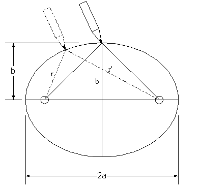

When you construct an ellipse using two pins and a thread, the pins being stuck into the two foci, the thread with length 2a tied to the pins, and a pencil run around the perimeter bounded by the taut thread, then the sum of the two radii defined by the pencil-to-pin thread sections is a constant 2a.
In the figure, r + r' = 2a. Now, when the pencil reaches the vertical mid line of the ellipse, r = r' so then r = a.

The situation could have been like this, with a the radius of the circle.
In this case the velocity is parallel to the initial x-axis also, and a isn't the major axis.

No, the original diagram for the problem indicates that the major axis of the intended ellipse lies along the x-axis.
Also, not just any ellipse will do -- it must have a total energy consistent with the kinetic and potential energy at the instant it is created (at the course change). A body on a circular orbit of radius a has an orbital velocity of ##v_o = \sqrt{\mu/a}##. So its specific kinetic energy, being ##v_o^2/2##, is ##\mu/(2a)##. The specific PE is ##-\mu/a##. That means the total specific energy is
