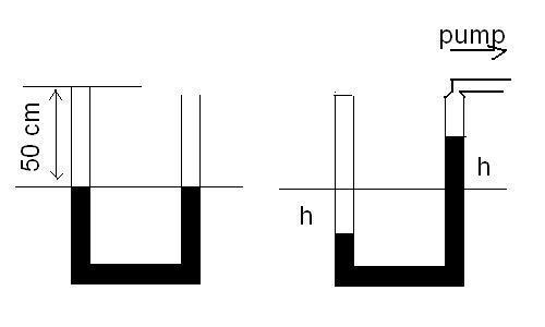

A u-shaped tube with a 1 square centimeter cross-section is filled with mercury to a depth of 50 centimeters on each side.
One side is capped and the air pressure is 750 Torr. The other side is connected to a vacuum pump.
a) how far does the mercury in the dupe drop on the left side? b) what is the final pressure of the air there?
(We are assuming a constant temperature)

The mercury is at depth 50 cm in both tubes initially. At the end, it stands 2h higher in the right tube with respect to the mercury level in the left tube. With respect to that level, the pressure must be the same at both sides: At left, it is the pressure of the air. At right, it is the pressure of the 2h high mercury column.
ehild

OK, then would that mean the expression I want is
[itex](\rho_{Hg}2h)(2h) = P_{final}(50+h)[/itex]?
because when I use that we get an h2 term and I have a quadratic with no real solutions.
No. Pfinal is Po(50/(50+h))=2hρHg.
ehild

That equation is wrong. Write the equation for the pressures at both sides.
ehild

Right, but the initial pressure is 750 torr which is the pressure of a 750 mm =75 cm high mercury column. The hight of the mercury in the tube is measured in cm-s: 2h=100 cm. Change 750 mm to 75 cm.
Emspak said:
[itex](100h+2h^2)cm2=(750 mm)(50cm) [/itex]
[itex]100h+2h^2 = 3750[STRIKE]0[/STRIKE][/itex]
The correct equation for h is [itex]100h+2h^2 = 3750[/itex] Solve it for h.
ehild
