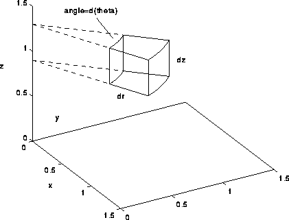

why is it dz.dr.rdθ? is it the volume of a small cylinder?
Basically it's the volume of an infinitesimal cylindrical shell with mean radius r, thickness dr and height dz (think of a ring with a rectangular cross section).
then its volume should be 2πr.dr.dz.
Ah yes, my apologies. Think of a chunk of a ring with the ring being cut along the diameter, from two infinitesimally close diameters. Then the volume element is [itex]dV=rdrd\theta dz[/itex]. Basically the r term comes from the Jacobian, which is required in order for the volume element be invariant when performing a coordinate transform [itex](x,y,z)\rightarrow(r,\theta,z)[/itex], so [itex]dV=dxdydz\rightarrow dV'=|J|drd\theta dz=rdrd\theta dz[/itex].
Do you have picture of this? its difficult to visualize.
is this the shape?
