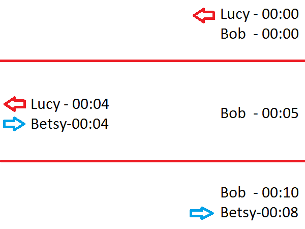

I find the discussion about acceleration confusing. I want to avoid that.
So try this scenario: Lucy is traveling at .6c relative to Bob. Just when they reach their point of closest approach, one kilometer, they synchronize clocks.
As their distance increases, each of them sees a red shift. Each estimates the other's time is dilated by a factor of gamma, that is 1/sqrt(1-.6^2)=1/sqrt(.64)=1/.8
After some distance, Lucy meets Betsy who is traveling the opposite direction at .6c relative to Bob. When they reach their point of closest approach, one kilometer, Lucy gives Betsy her clock's current time and Betsy sets her clock by it. Betsy and Bob will both see each other's light is blue-shifted. They both calculate the other's time is dilated by a factor of gamma = 1/.8.
When Betsy and Bob reach their point of closest approach, one kilometer, they exchange times. Which clock will be ahead, and by how much?
I believe that scenario is pretty simple..

I also believe that is crucial, so we will say 5 minutes has passed on Bob's clock since Lucy passed and synced her clock, we can call this sync 00:00. At this time 4 minutes has passed on Lucy's time dilated clock and she syncs Betsy's clock to 00:04. Since she would be the same distance from Bob it will take another 5 minutes on Bob's clock until she passes him. At that point her clock reads 00:08 and Bob's clock would read 00:10.
Let's say that 4 minutes has passed on Lucy's clock when she sync's Betsy's clock.
Lucy's situation is exactly equivalent to Bob's, and she has exactly as much reason to think that Bob's time is dilated compared to hers, as Bob has to think her time is dilated compared to his. Her clock reads 4 minutes so she can calculate Bob's proper time, it is 3.2 minutes.
Independent of Lucy, Betsy has every reason to think that Bob's travel at .6 c will cause his time to dilate. If her clock reads 4 minutes when she reaches Bob, it is predictable that Bob's clock will have advanced 3.2 minutes.
Since both of these independent inertial frames are as valid as Bob's, and they are clearly sequential, one starting at precisely the time and place that the other ended, Betsy is justified to conclude that Bob's proper time is 6.4 minutes.
But of course Bob's actual proper time is not 6.4 minutes or 8 minutes but 10 minutes.
Why is it that Lucy's view and Betsy's view are both wrong?
This is what I imagined by your description. Lucy and Betsy would pass at 1.2c relative to each other...

Bob's clock will be ahead; as you say in a subsequent post, his clock will read 10 minutes, and Betsy's will read 8 minutes. Of course this result is simple to derive in Bob's frame.
If you try to analyze the scenario in Lucy's or Betsy's frame, the key thing you have to include, that it doesn't seem like you're including, is relativity of simultaneity. Bob, Lucy, and Betsy all have different simultaneity conventions, and that fact must be included when you are comparing readings on their clocks.

You also need to add velocities correctly using the relativistic formula, which jethomas3182 gave you. If V1 = V2 = 0.6, then their relativistic "sum" (i.e., the relative velocity of Lucy and Betsy) is (0.6 + 0.6) / (1 + 0.6 * 0.6) = 1.2 / 1.36, or about 0.88.
The way I read it, Betsy's clock will have advanced 4 minutes since she left Lucy. She might not feel it appropriate to count Lucy's 4 minutes, but might instead translate them to the time that seems right for her own frame. But it's a picky point.
I don't see what to do about that. The events I look at are Bob and Lucy together at the same time and place, Lucy and Betsy together at the same time and place, and Betsy and Bob together at the same time and place. We never have to think about any other simultaneity.

According to the OP, Betsy sets her clock to read the same as Lucy's when she passes Lucy. That's why I said her clock would read 8 minutes when she passes Bob.

But there is no frame (and can't be) where all three of these events happen at the same place. So in order to analyze all three events in any frame, simultaneity will come into play. The only way to avoid it is to just look at the lengths of each of the sides of the triangle formed by these three events; and those side lengths are 10 (Bob/Lucy to Bob/Betsy), 4 (Bob/Lucy to Lucy/Betsy), and 4 (Lucy/Betsy to Bob/Betsy). This leads to a "traveling" result of 8 (4 + 4) and a "stay-at-home" result of 10, as has already been said.

No, I don't think that's right. Both of them see Bob's clock ticking slower. Each of them sees Bob's clock ticking 3.2 seconds while their own ticks 4 seconds.
This is required by SR.
But we can't just add 4+4 to get 8, and we can't just add 3.2 + 3.2 to get 6.4.
Arithmetic doesn't work that way in SR, just as we can't add velocity .6 c to velocity .6 c to get velocity 1.2 c.
But those two intervals of 3.2 seconds do not cover the entire length of Bob's worldline between the two meeting events; i.e., they do not cover the the entire length of the third side of the triangle in spacetime (see below). There is a gap in between them, 3.6 seconds long, corresponding to the change in simultaneity conventions between the outgoing and ingoing legs of the traveling twin's trip (or between Lucy and Betsy, if you look at it that way).
Sure we can. Each 4 is the length of one side of a triangle in spacetime. Adding the two together gives the combined length of the two sides. This can then be compared with the length of the third side (10). It's just geometry.

What kind of calculation would you be doing where it's appropriate to add his four second to your four seconds?
A calculation comparing the sum of the lengths of two sides of a triangle in spacetime with the length of the third side, as above. Again, it's just geometry.
Physically, the sum of the lengths of the two sides gives a very good approximation to the proper time experienced by a traveling twin who turns around very sharply at the vertex of the triangle between the two sides of length 4. Understanding that this calculation is just geometry, and doesn't depend on your choice of coordinates, can help to drive home the point that the traveling twin will be younger than the stay-at-home twin when they meet up again, and that that fact is independent of your choice of coordinates; it's an invariant fact that arises from the geometry of spacetime.
I'm no saying you're wrong, but I don't understand it.
What I see is that when you convert from Lucy's time to Betsy's time it converts to 6.8 seconds. Betsy thinks Lucy's clock is slow relative to hers, even slower than Bob's clock is relative to Lucy's clock. There's no gap, just a conversion.
Usually when I add two vectors I don't just add their lengths. There are times when that's appropriate, like when you want to measure a perimeter. But I don't yet see that it's appropriate now.

Look at figure 4 of this page from the Usenet Physics FAQ article. The left (vertical) side of the triangle corresponds to Bob's worldline. The lower right side corresponds to Lucy's worldline. The upper right side corresponds to Betsy's worldline. The two sets of blue lines are the lines of simultaneity corresponding to Lucy and Betsy. Notice the gap in the middle of Bob's worldline, where no blue lines intersect it.
The numbers in question (the two 4's and the 10) are not vectors. They are lengths of sides of a triangle in spacetime.
