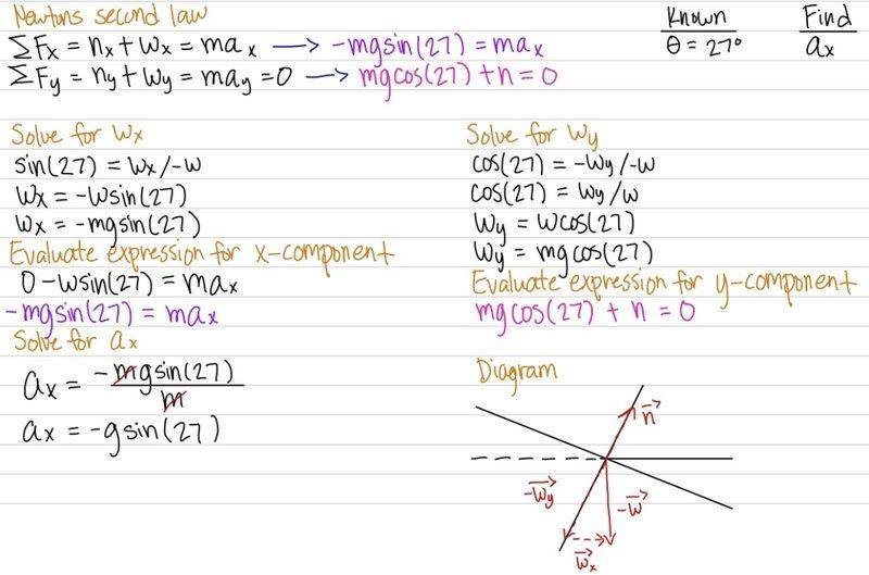

I understand in my head that Wx = mgsin(27) and Wy = -mgcos(27). Though when I tried solving for both Wx and Wy, their signs turned out to be opposite. I've provided my work leading up to Wx = -mgsin(27) and Wy = mgcos(27). Maybe I interpreted the signs of x and y component of W?

The weight vector should be denoted ##\vec w##, not ##-\vec w##. The vector ##-\vec w## would point in the opposite direction of the weight.
Also, in you diagram, you drew ##\vec w_x## as horizontal rather than parallel to the x axis. (Note that your y component of the weight is larger than the weight w.)
