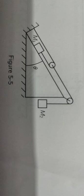

In the system shown in Fig. 5-5, M1 slides without friction on the inclined plane. Θ=30°, M1 = 400g, M2 = 200g. Find the acceleration a of M2 and the tension T in the cords.
First I determined the direction the masses will be traveling by comparing the change in potential energy, so when M2 rises by Δy, M1 drops by Δy. Potential energy decreases when M1 drops and M2 goes up.
Tension force for string pulling against M1= 400 x gsin30°, and since there are two strings pulling against the pulley, force caused by the lower pulley = 400g.
Tension force due to M2= 200g.
Net force=400g-200g=200g=0.200 x 9.81= 1.962N
Acceleration = 1.962/(0.400+0.200)=3.27 m s^-1
T=1.962N.
My answer feels off, so I checked the answer, and the answer's acceleration is g/9= 1.09, T=2.17782N
Could anyone help point my mistakes?
This makes no sense to me Where is ##\theta##? Where is effect of the second pulley?
Does θ and the second pulley have any effect? I couldn't see it so it's my bad.
Yes, they do!

You can do it by forces or think about energy - at least to see the effect of the slope and pulley.
There are many mistakes. Here are just a few points to think about.
When using the formula ‘weight = mg’ with SI units, what units are used for m?
Why is it wrong to equate the tension acting on M₁ to the downhill component of M₁’s weight (which I think is what you have done) in this problem?
In the diagram there are 2 separate ropes. Are the tensions in the 2 ropes equal? If not, how are they related?
Would it be a good idea to draw a fre-body diagram of each mass?
This problem is based on what is called an ‘Atwood machine’. If you are not familiar with Atwood machine calculations, I would highly recommend reading about them (and understanding) before attempting this problem.
Please forgive my omission of units in my calculations.
I think it's because M1 is accelerating, so you can't equate it. However, one doubt I have in my mind is whether the tension on m1 should be greater or smaller than the downhill component of M1. My guess is that it should be smaller so that M1 can accelerate downwards.
After looking at it again, I think they are probably not equal. My best guess is that the string pulling against M2 has a higher tension than the one pulling against M1, but the next effect of string pulling M1 is higher than the tension on M2.
It is not necessary to guess. Just choose which way you are taking as positive for its acceleration and write the equations accordingly.
Quite so, so assign two different variables.
What forces act parallel to the slope on m1?
Letting the tension of the ropes correspond to the masses, i.e T1, T2.
Force on M1 is M1gsin30-T1. Force on M2 is T-M2g. Force on pulley on the slope is 2T1 - T2. Is that right so far?
Yes. Since you are not given a mass for the pulley, assume it has none. What equation does that give you?

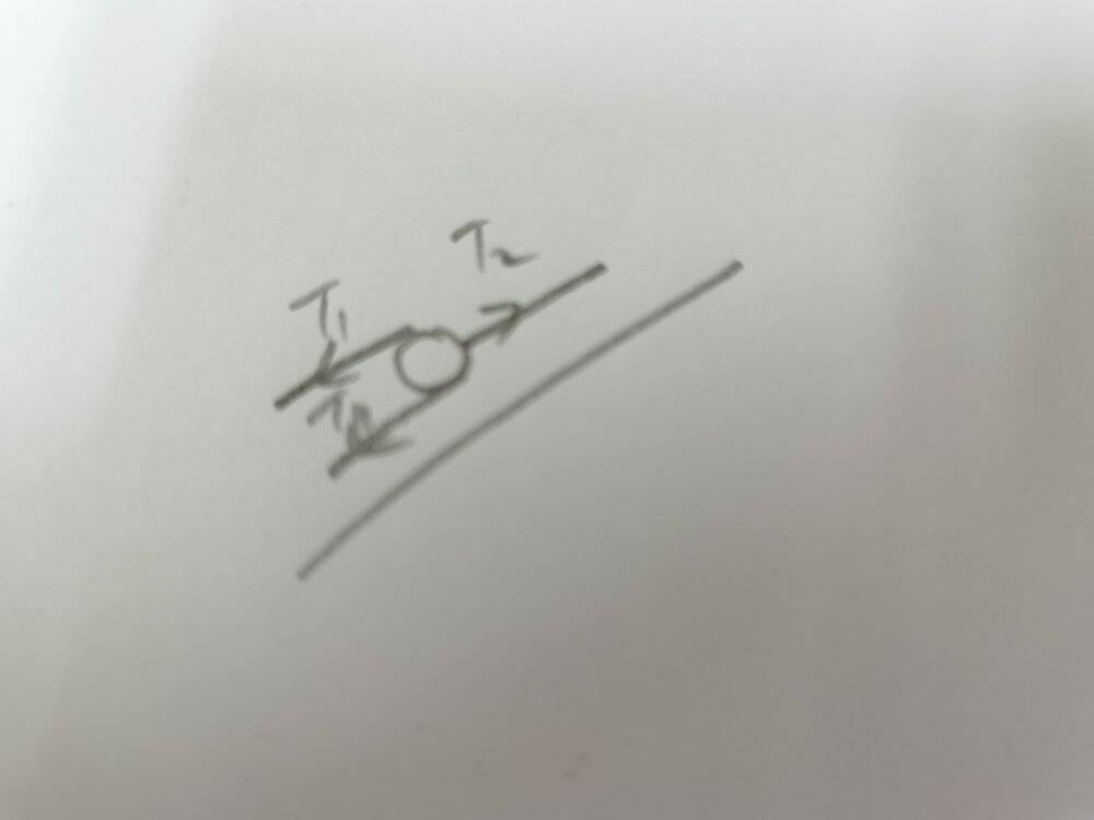

I'm chipping in.
1. Draw a free body diagram of the pulley (the one near M₁).
2. What are the forces directly acting on the pulley?
3. What is the resultant force on the pulley?
4. Now apply 'F =ma' to the pulley (remembering the pulley has negligible mass).
5. You should now have an equation relating the tensions. If you don't, post your working for each of the above steps.
Ithilrandir said:
I had assumed the net force to the be same across the string. Judging by your reply it seems to be wrong.
As I wrote in post #14
Or to put it in more detail, what @Steve4Physics wrote in post #28.
Steve4Physics said:
I'm chipping in.
1. I've uploaded a free body diagram of the pulley near M1.
2. Forces directly acting on the pulley are the two T1 acting down the slope and the T2 acting up the slope.
3. Resultant force = 2T1 - T2
4. If the pulley has negligible mass, F = ma shouldn't be calculable?
