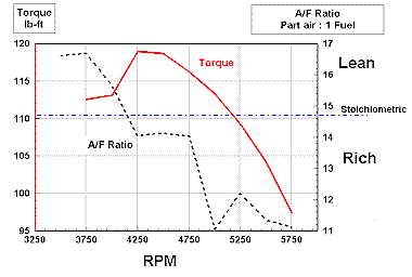

congratulations fellows..you have just entered the world of hot rodding. Since the first IC came off Henry Ford’s production line the first guy to tinker with it wanted to go faster than the other guy. You have asked the one big question- How to make the IC go faster.
As one old hot rodder told me when I was learning to trouble shoot the IC engine.
you need fuel, you need air and you need a spark...AND... the spark at the proper time.
Nothing happens until we enter a fuel/air mix into the engine. It must be ignited at the proper time to make power.
The stoichiometric air-fuel ratio (14.7:1) that is the ideal ratio for lowest emissions, but this isn't the best ratio for power. It used to be that 12.5:1 was considered the best power ratio, but with improved combustion chambers and hotter ignition systems, the ideal now is around 12.8:1 to 13.2:1. This is roughly 13 parts of air to one part fuel. It's what combustion engineers call an excess fuel ratio and is intended to ensure that all the air is used to support the combustion process. This is because air is the oxidizer in combustion. Too many racers think that adding additional fuel beyond the ideal to create a richer mixture will make more power. This doesn't work because you can only burn the fuel when you have enough air to support combustion. That's why engines make more power when you add a supercharger or nitrous--you're shoving more air in the cylinder so that you can burn more fuel. Regardless of the amount of air in the cylinder, it still requires a given ratio of fuel to burn. Add too much extra fuel, and power will decrease.
The intake manifold is a big pipe and you can only fit so much fuel/air thru it..period. Typical normally aspirated internal combustion engine. So we start using superchargers to cram in more mix.
regarding the ignition. Todays advanced CD ignitions actually provide multiple sparks at idle and low RPM and provide a long spark at high RPM ( long being in crankshaft degrees). It does this to make more efficient burning of the fuel air mix at idle and higher RPM. We went from 25000 volts at the spark plug and a small gap of .025” to 50,000 plus volts over a 0.060 to .080 gap to again, more completely burn the mix.

That is not true, you do need a constant 14.7:1 fuel to air ratio for the optimum performance of your engine, to make it simpler, forget about idle for a moment, at 3000 rpm you should and in reality would get that ratio and at 6000 rpm again this is exactly what you will get
what happens when you floor the throttle especially in old cars is you deliberately inject more fuel THAT WILL NEVER BURN and therefor will not contribute in the whole process and again this is the kind of deficiencies I'm not talking about :wink:
As far as I know, that optimum ratio is used at or near top rpm. At the idle, I don't think all engines make use of the optimum ratio.. it is lower than that, i.e., lesser fuel than in the optimum ratio. In other words, a leaner mixture. A richer mixture than the optimum does not provide power, I agree. But a leaner mixture than the optimum obviously produces less power>>lower rpm!

it is true that the rate of filling the cylinders does vary, but the fuel to air ratio is not supposed to, even if it does for some extent, I don't think it's intended as a means to vary the rpm, but rather to enhance economy as is the case with new Toyota and Honda engines or simply due to some out of control defeciency

Compression ratio decides pre-ignition and is RPM dependent. Power at low RPM requires lower CR to prevent pre-ignition. At high RPMs, a higher CR improves fuel economy, since there is insufficient time to pre-ignite. CR should not be held constant.
With direct fuel injection, the AFR needs to be varied over the whole range. It is only when high octane fuel and concern over NOx emission is concerned that AFR must be carefully adjusted to remain stoichiometric.
