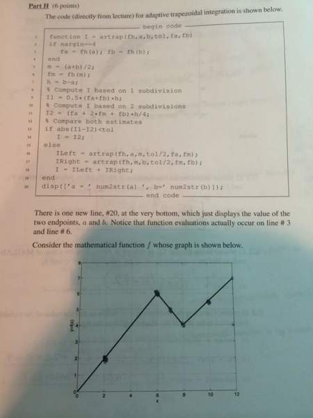

Here is the code for the adaptive stepsize function
Code:
function I = arttrap(fh,a,b,tol,fa,fb)
if nargin == 4
    fa = fh(a); fb = fh(b);
end
m = (a+b)/2;
fm = fh(m);
h = b-a;
% Compute I based on 1 subdivision
I1 = 0.5*(fa+fb)*h;
% Compute I based on 2 subdivisions
I2 = (fa + 2*fm + fb)*h/4;
% Compare both estimates
if abs(I1-I2)<tol
    I = I2;
else
    ILeft = artrap(fh,a,m,tol/2,fa,fm);
    IRight = artrap(fh,m,b,tol/2,fm,fb);
    I = ILeft + IRight;
end
disp(['a = ' num2str(a) ', b=' num2str(b)]);
I am wondering if I did it correctly, or better yet if just by looking at the graph I would be able to tell the values of ##x## which are evaluated. This can't be plotted to test, so it's clear this was a contrived graph to test the student's understanding of how adaptive stepsize integration works. I am just wondering what would indicate the places that would be checked.
From what I see, 2 and 10 would be looked at. Then also 6 and 8, since there is a sharp turn at those locations, and a step could be placed there. But my calculations are saying that it's also evaluated at 7 and 9.
The computer doesn't magically "know" where the kinks in the graph are and put the steps and the "best" places. It just does what the program tells it to do.
I think you are right about evaluating at 7 and 9. The interval 6 to 10 doesn't converge so it is split into 6 ro 8, and 8 to 10. The computer doesn't "know" what the graph looks like, so it has to evaluate at the mid point of those intervals. Both intervals converge so they are not split any further.
The marks on the graph, and the answer on the second sheet, forgot about checking the interval 2 to 6.
BTW this is a poor algorithm for doing integration (but it's a nice exercise related to trees and recursive functions). See why you get the wrong answer, if you use it to evaluate ##\int_0^{2\pi} \sin^2\!\! x\, dx##.
