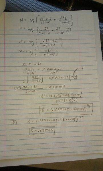

Thank you. I did fix the integration with the moment portion for the hydrostatic force from 0 t y = h/sin(theta)

I posted pictures of my new working below. I do appreciate the help
That all looks pretty good, except that you went wrong early on.
I gather you are taking g as having a positive value, so switched the sign on dP/dz to minus. But that should change the sign on the constant of integration too. Look at your expression for P(z) and consider its value when z=h.
Thanks for the response. I will have to fix that as P should be zero when z = h
Update: Wonderful . After fixing it properly, everything seems to be within range. Thanks again for your help :)
