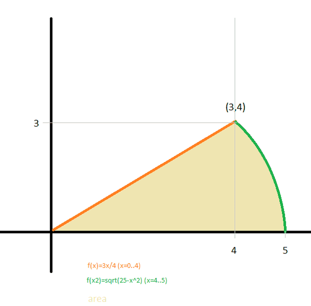

Interpret the integrals (from 0 to 4)∫ (3x/4) dx + (from 4 to 5)∫ (sqrt(25-x^2)) dx as areas and use the result to express the sum above as one definite integral. Evaluate the new integral.
I see that I could integrate them separately and add the two values to find the total area. The issue I am having is writing them as one integral. I suspect that one way would be to re-write one with the equivilant function but using the limits of integration of the other. However, the only way I've ever changed limits of integration (and all I can find using searches) is when you're doing a u-substition and I'm not sure if the same methodology applies here.
Can I simply add '4' to the first function, 3x/4, to move it over 4 units to the right and then stick that whole thing, 3x/4 + 4, into the other integral between 4 and 5 (along with sqrt(25-x^2)? That would look something like:
the integral from 4 to 5 of (sqrt(25-x^2)+ 3x/4 + 4) dx

What does the region you are finding the total area of look like? Can you describe it geometrically?
Sure, a straight line starting at the origin up and to the right (described by 3x/4) and when x=4 the function curves downwards and ends up at (5,0) (described by sqrt(25-x^2). I did this by graphing them both separately and visualizing the combination. Maybe that's skipping a step you're looking for me to take?
EDIT: Sorry, I described the line. The region would be the area between that line and the x-axis.

What does the curve y=sqrt(25-x^2) look like geometrically? Answer that one and if you are still confused, I'll tell you the answer I'm fishing for.
Half of an oval. More specifically, the 'upper' half of an oval with the longest axis parallel with to y-axis. Similar to a parabola.
I suspect that you'd want me to express this in a polar system. I don't know how to go about this :(

I'd call your 'oval' a 'circle'. The region whose area you are finding is a sector of a circle. Hence, Mark44's hint about polar coordinates. And it's not a double integral. Look up 'area in polar coordinates'.
The end point of the first segment is (5,arcsin(3/5)). Working on the second now.
You can probably stop working on it, because I don't know what you are talking about. The region is a region sliced out a circle that looks like a slice of pie. It has fixed radius and a beginning angle and an ending angle. Work on those instead.

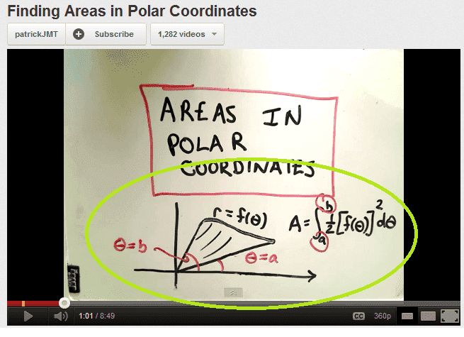

What I think you're looking for now is something like this: (extracted from a youtube video from patrickJMT titled 'Finding Areas in Polar Coordinates').
What I'm having a hard time doing is visualizing the -addition- of the two functions while they sit on top of one another finding two different values for theta. That idea makes me think subtraction, not addition. Thoughts?

The point where the two lines meet in the first picture I posted is described in polar form as (5, arcsin(3/5)). arcsin(3/5) is the angle theta that the first function makes with the x-axis and 5 is the radius.
You've got exactly the right polar coordinate reference. But forget about adding anything. Now you have a single simple region. Find it's area with a single simple integral in polar coordinates.

Sure, you can use horizontal strips to integrate, but the simplest way, by far, is a polar integral.
The polar function is r = 5, with θ ranging from 0 to tan-1(3/4).
The integral is
[tex]\int_0^{tan^{-1}(3/4)} \frac{25}{2}dθ = 12.5 \cdot tan^{-1}(3/4) ≈ 8.0438[/tex]
