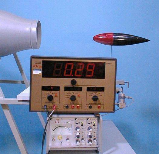

hi there, I'm new (you see ;) ) and would like to know more about movement under air resistance or how its called (drag-movement?)... I'm from germany and do understand english, but not perfect...
i have already some information about drag, but would be pleased if you could give me more information, not only about drag, but also about movement under air resistance... to be more specific i do not really need much infos about "more than 220mph" (balistic or how its called) but would be nice to read also some of it... hope you understand me?!

hmm more specific? i will try...
the situation is as follows: i have the task (as far as i know jet) about "movement under air-resistance" (or drag-motion or so (in german called "bewegung mit luftwiderstand")) and what I've done till now is to collect all information i could find about air-resistance... but always when i want to know more i get into another "topic" like air-planes, or balistic (bullets)... and as we have holidays now here in germany i don't knot what exactly my teacher want me to study about, so I'm waiting for some emails to be answered... furthermore i will do some test in school for showing drag, and that's (i think) the point, because when i record the test with a camera and do a report about the tests with some pictures in it, i think there will be no more place in the guideline of about 15 pages with given font and size of it, to talk much about drag by/of air-planes or so... so i think i should stay near my tests i will do... the tests are ... hmm how do i explain: we have i kind of "hover-board" in school ("luftkissenbahn" google says "air cushion course") with a plate on it for showing the drag... i don't know how to explain, but first o would like to know how to do some tests about drag... i have seen some on the internet, but our school do have have that "thing" with tells you the "Cd" (the picture below show the "thing" i mean), but nevertheless i think we have enough stuff in school to do some tests, so you could help me if you have any idea of doing a test or tell me with parts i MUST incude in my written work... (like to start with some deffinition of drag...)
hope you understand me, if not, tell me and i will try to explain in a different way... thanks for the replys ;)
edit: damn i can't see the attached pic? why?
