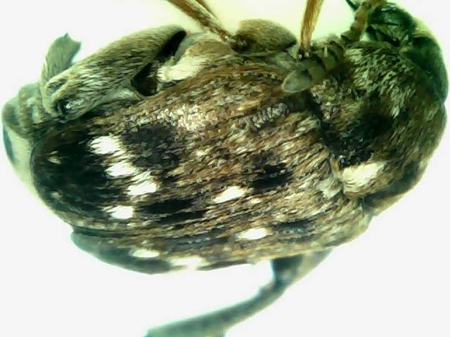

Anyways, even at 17x magnification, bugs are HUGE!
This poor sod, is 2 mm across the shoulders:
I say poor, as I froze it for a month at -10°C, and when it awoke, I drowned it in isopropyl alcohol for half an hour. When that didn't kill it, I lit it on fire.

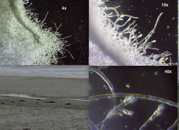

My other microscope cost about $300, and is most fantastic. I have seen bacteria, Swimming!
But fungi are more photogenic.
Here's something that grew in some tea that I left out a bit too long:
I'm guessing it was with my 40x objective.
Here's a fungus culture I grew from my mouth. Prior to putting it under the microscope, I thought the colony was bacterial.

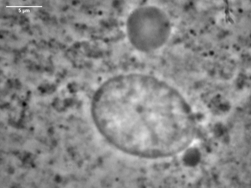

Close: it's the numerical aperture (f-number). The rule of thumb is that empty magnification begins around 500 to 1000 times the numerical aperture.
When I look at this image (a selfie) at 100%, it corresponds to a magnification of 8000x, but when posted here it's only a paltry 6000x:
(It's a nucleus in one of my cheek epithelial cells, not sure about the tiny black spots... ). When re-scaled to 'maximum usable magnification' it looks like this:

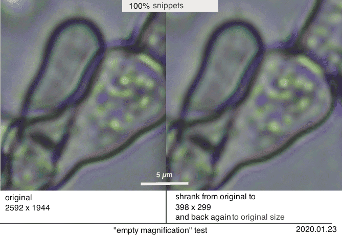

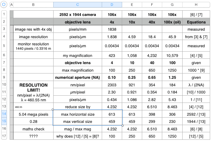

I spent most of yesterday and part of today testing this "maximum usable magnification" thing.
It appears to be true!
I can't really tell much difference between the original and the one that's been through the wringer washer.
According my my maths below, I could have gotten away with a 0.3 megapixel camera vs the fancy 5.0 megapixel camera I went out of my way to pay extra for!
One consolation though, is that the 5.0 megapixel camera fits my camera-less telescope!
I tested it the other day on a tree across the street, and it looks as though Saturn will be about 39 pixels across, rings not included.
In microscopy, the camera pixel size is a critical metric. For example, it may be surprising that imaging with a 10x/0.3 lens requires a smaller sensor pixel size as compared to imaging with a 100x immersion lens in order to match the pixel size to the size of the point spread function.

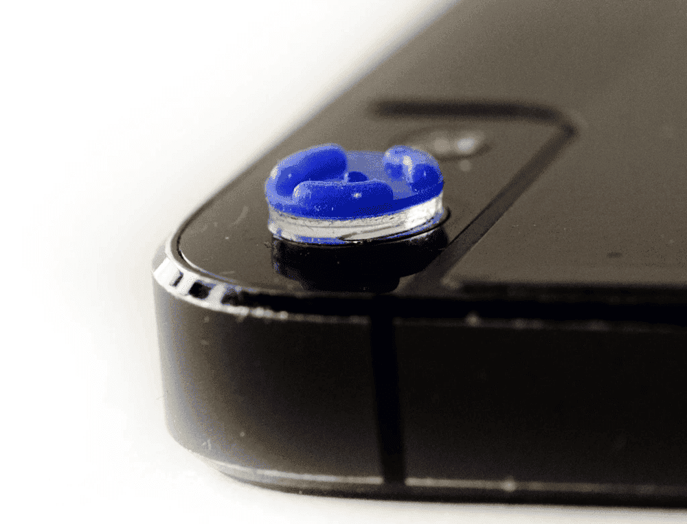

I have tried several optical attachments for smart phones so they can function as microscopes.
They have generally been disappointing.
