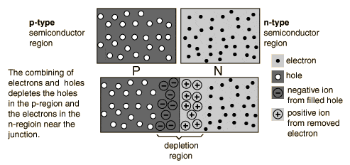

It is a common misconception that the BJT would be a current-controlled device. Surprisingly, this false statement even can be found in some textbooks.
Instead, you can trust some papers from leading US unversities explaining that the BJT is voltage controlled - and the base current is an unwanted but unavoidable byproduct.
Furthermore, it is very easy to proove on a circuit level (without going deep into the physics of the pn junction) that it is the voltage Vbe that controls the collector current.
I think, everybody who knows and understands the working principle of a pn junction (pn diode) cannot come to the conclusion that the pn junction within the transistor behaves completely different.

for (a): This involves carrier physics, which I don`t like to discuss at the moment (to involved for such a forum). On the other hand, we all know the "mystic" value of dVBE/dT=-2mV/K which tells us that - for a temperature caused increase in the collector current Ic - we have to reduce the base-emitter VOLTAGE by 2mV in order to keep Ic constant.
