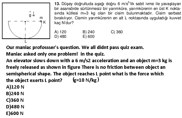

An elevator slows down with a 6 m/s2 acceleration and an object m=3 kg is freely released as shown in figure There is no friction between object an semispherical shape.
The object reaches L point what is the force which the object exerts L point?
A)120 N
B)240 N
C)360 N
D)480 N
E)600 N
For elevator
a=6 m/s2
V2=Vo2-2ah
V=Vo-at
h=(a/2)t2
For object
inside the elevator gravitational constant g'=16m/s2 because
N-mg=ma
N=m(g+a)=mg'
I can't solve I need help

kerimabdullah said:
For object
N-mg=ma
N=m(g+a)=mg'
what about the centripetal acceleration?
(and if the elevator is going up but slowing down, isn't it 4 not 16?)
solution how to? g'=16m/s2 is correct
N-mg=ma+(m/r)Vfinal^2
Energy equation? m(g+a)Integral(rdr)? Because The height is changeabele for every second This is Turkish Physics Olympiad Question. I couldn't solve
Or (1/2)mV^2 +m(g+a)Integral(rdr)= (1/2)mVfinal^2
This is a very interesting and challenging problem. In addition, as Tiny Tim pointed out, there is some ambiguity as to whether the elevator is moving upward initially, and slowing down, or whether the elevator is moving downward initially, and slowing down. So I guess it's best to work the problem both ways, and then to see whether either solution matches the choices offered.

Lets suppose the elevator moves with constant velocity downward and a man press the button to stop elevator then elevator makes slowing down motion downward with a=6m/s2 and angle and height for the object changes with the time.
If accelerating upward 6m/s2
v2=2aL
a=6+10
ac=32m/s2
F=m(32+6+10)=3(48)N
None matches.

If the mass were 30 kg, rather than 3 kg, then one of the answers would make sense. If the elevator were initially moving upward and decelerating at a rate of 6 m/s2 and the mass were 30 kg, then the contact force would be 360 N. According to my analysis of this problem, the contact force on the mass at point L is given by:
N = 3m (g + a)
where a is the upward acceleration of the elevator. If a = -6 m/s2, and m = 30 kg, then N = 360 N.
The main part of this problem is deriving the above equation. See if you can confirm my result.
