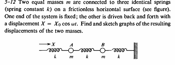

Well, i think the important here is the system, what you think about?:
-2kx2 + kx1 = mx2''
-2kx1 + kx2 + kXocos(wt) = mx1''
After this, is just solve, i found:
x2 = (k*xo*cos(wt)*(4k/m - 2w²))/(2m*(k/m - w²)*(3k/m - w²))
The cool is that if we put w equal the two normal frequency x2 tends to infinity (so resonance in this case)
about x1 i will solve later, but before i want to know if at least the system is right
I agree with your ODEs.
