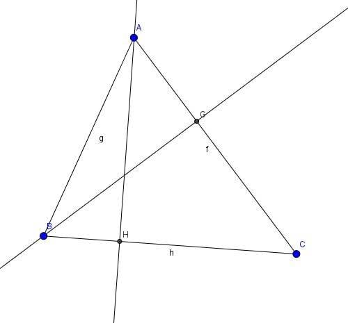

Thank you for the assistance.
There is something wrong, or that I do not understand in your solution.
I agree that the slope of BG is 3/4 like you said. But why is the distance between G and A is 5 ? The distance between B and G is 5. I am slightly confused. The line AC is y=(-4/3)+(13/3). G is on this line and the distance from G to B is 5.

What I am saying is that $B$ must lie on the red line:

Perhaps a simpler way to determine the coordinates of point $B$ is to observe the that area $A$ of the triangle must be:
$$A=\frac{1}{2}bh=\frac{1}{2}\overline{AC}\cdot5=\frac{5}{2}\sqrt{9^2+12^2}=\frac{75}{2}$$
We may also write:
$$A=\frac{1}{2}bh=\frac{1}{2}\overline{BC}\cdot\sqrt{45}=\frac{\sqrt{45}}{2}\sqrt{\left(7-x_B\right)^2+\left(\frac{4}{3}\left(x_B+3\right)-5\right)^2}$$
This implies:
$$\left(7-x_B\right)^2+\left(\frac{4}{3}\left(x_B+3\right)-5\right)^2=125$$
Solving this, we get:
$$x_B\in\{-3,9\}$$
And so this gives us two possible locations for point $B$:
$$B_1(-3,0)$$
$$B_2(9,-16)$$
