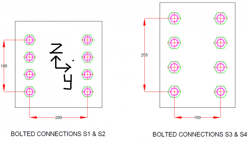

Hello,
I am trying to analyze a bolted connection. I don't remember anything about bolt connections, so I am studying at the same time ( the purpose is to actually study before actually designing a bolted connection). I designed the system itself and found the stresses on the connection and trying to understand whether the current bolt system is enough to support it.
Here is the problem: The bolted connection has 8 M20 bolts, 4 at the left hand side and 4 at the right hand side, so not symmetrical. The connection is under all kinds of forces and bending moments, so Fx, Fy, Fz and Mx, My, and Mz are all present (x being the direction perpendicular to the cross section). The stresses due to bending moments are where I am stuck.
Here is what I did so far:
I assumed only the four bolts at the corners are carrying the loads so that the arrangement becomes symmetrical for simplicity. For example, the bending moment in the y direction is 7500000 Nmm. I carried this bending moment to the centroid. The distance between a bolt and the centroid is about 150 mm. So the summation of moments on each bolt should be equal to the actual bending moment. Is that a correct procedure (this is what I get from the textbook)?

I attached the picture, this is the bolt arrangement. Sorry I am in a hurry and just inserted the axes in paint haha. I made up the dimensions in the first post but this is the actual system. I performed an analysis and found the support reactions in the system, Fx, Fy, Fz, Mx, My, Mz. Trying to find out if the bolt arrangement is enough to support these support reactions.There is also another attached 3d pic of the actual system.
  • Two CAD drawings of bolted connection plates: left plate with eight bolts in two columns, spacing 180 and 200; right plate with eight bolts in two columns, spacing 255 and 160; handwritten axis arrows labelled Z and Y on the left plate.

You are not correctly calculating bolt loads. For bolt tensile or compression axial loads caused by member bending moments, you first need to calculate the moment of inertia of the bolt pattern. That value is the sum of the Ad^2 values if each bolt, where The bolt area A you can assume as 1, and d is the distance of each bolt perpendicular from the neutral axis through the centroid. Then the load in each bolt is the familiar Mc/I . The load is in force units because we assumed A is 1. Use all 8 bolts, not just 4. Now I don't know what your numerical values are, since you posted 2 different figures with different numbers, then used another number in your calcs. Assuming about the z axis the bolts are spread 200 units apart in the y direction , and M is 1,000,000 say, then I = 8(100)^2 = 80000 and the bolt load in each bolt is (1,000,000)(100)/80000 = 1250. Or in this case it is simpler since the bolts share the load equally to just divide the moment by the bolt spread 1,000,000/200 = 5000 over 4 bolts or 1250 per bolt, same result. Use similar approach for M about y, must use inertia approach here, corner bolts see higher load. For the twisting Mx moment, this causes bolt shear forces, not axial forces, use polar moment of inertia J = Ix + Iy.

This is my solution so far:
Mz=12631221 Nmm
Total Ad2=8*(100^2)=80000 mm2
sigma=((12631221*100)/(80000*245))=64.45 MPa on each bolt.
My=6502447 Nmm
Total Ad2=4*90^2+4*30^2=36000 mm2
Coner bolts to y: 90 mm
Inbetween bolts to y axis: 30 mm
For the center bolts: sigma=(6502447*90)/(36000*245)=66.35 MPa on each bolt
For the mid bolts: sigma= (6502447*30)/(36000*245)=22.12 MPa on each bolt
Mx=5265769 Nmm
Total J=4*(sqrt(90^2+100^2))^2+4*(sqrt(30^2+100^2))^2=116000 mm^2
Corner bolts to centroid: 134.5 mm
Mid bolts to centroid: 104.4 mm
Corner bolts:
= (5265769*134.5)/(116000*225)=27.14 MPa on each bolt (225mm2 shear stress area of the bolt)
Mid bolts:
=(5265769*104.5)/(116000*225)=21.08 MPa
So for the critical corner bolts
Total Tensile Stress= 130.8 MPa
Total Shear Stress=27.14 MPa
Does this look correct (fingers crossed)?
yes looks very good. Now you have to add in the contributions from the Fx , Fy , and Fz loads.

Great. I think I got the forces down, just divide the forces by the total bolt area, which is total tensile stress area for the tensile x load and shear stress area for the shear y and z loads.

Yes, good work. Be sure to get resultant bolt shear stresses by vector additions of the shear stress contributions from Fy, Fz, and Mx, and then check bolt adequacy from combined tension/shear allowables.
