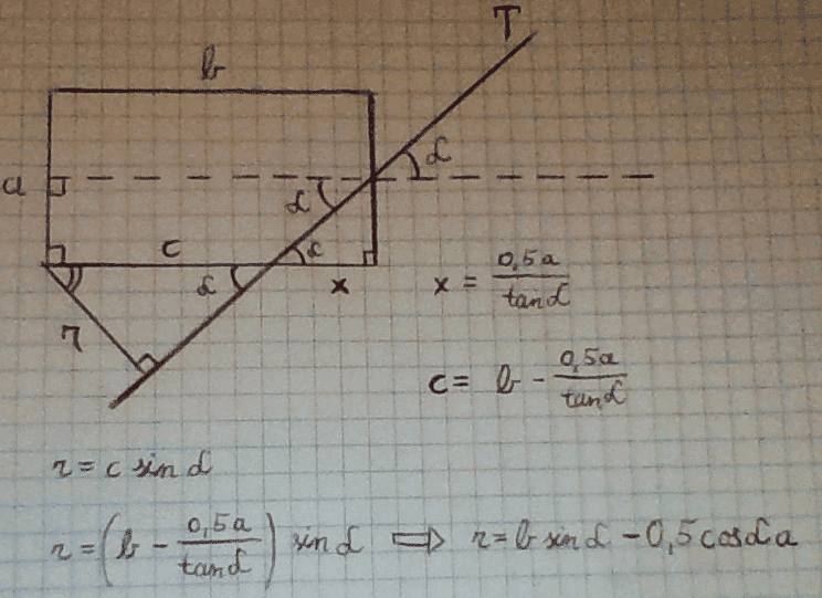

A rectangular box is being pulled by a rope with a force T on a horizontal surface, with a friction coefficient μ. What is the minimum angle α at which it will lift of the surface? See attached image.

The force T has vert and horiz components, and both components contribute a moment about the lower left corner of the block.
:sorry:If I understand Nascent correctly, then I wasn't supposed to add sin component to the torque. I was under the assumption that displacement vector has to be perpendicular to the force, but now that I think about it, it simply makes the torque maximum. If I don't have to worry about 90°, then the displacement vector from axis of rotation to the force applied will be

When evaluating the moment of a force (or a component of a force) about a point you need the perpendicular distance from the point in question to the line of action of that force (or component).
I don't see how can I make a right angle here between the force along the rope and the point, unless I'm imagining extension of a rope, in which case I'm lost at how I would calculate it only knowing the hypotenuse. What am I missing here?
That is exactly what you must do, extend the line of action of the force until you can form the right-angle. If you do it this way, the problem becomes an exercise in geometry because you need to determine that perpendicular distance in terms of a, b, and angle alpha.
Alternatively, you can resolve the force T into its vert and horiz components and calculate moments about that corner point due to these two components.I worked this problem both ways, the answers agree, but the second method was less complicated.

I've got my r expression, seems to check out with random values if I check by graphing
\begin{equation*}
r=b\tan\alpha-\frac{a}{2}
\end{equation*}

The leading edge of the block is about to lift off the surface, indicating the net torque about the trailing edge = ??
\begin{equation*}
\end{equation*}
Draw a large figure, check this carefully.
If there is no angular acceleration, then the net torque is zero; its used to overcome friction and mg, right?
That is embarrassing, but seems I fixed it
\begin{equation*}
r=b\sin\alpha-0.5a\cos\alpha
\end{equation*}

Totally, i honestly feel you're complicating this.
I highly recommend, you try the other method, of you have not.
The T you have, you could have got the components which you have
Totally said:
x and y components of T are Tcosα and Tsinα.
then gét their distance from the point of contact (left down). then get the equation for moments.
Totally has got through the hard part, the remainder is no more complex than the alternative, so may as well finish this, now.
