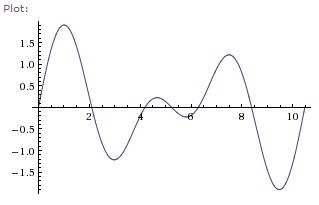

Here is a plot of the function over one period:
The nodes for this period are at:
$$x=0,\,\frac{2}{3}\pi,\,\frac{4}{3}\pi,\,\frac{5}{3}\pi,\,2\pi,\,\frac{8}{3}\pi,\,\frac{10}{3}\pi,\,$$
