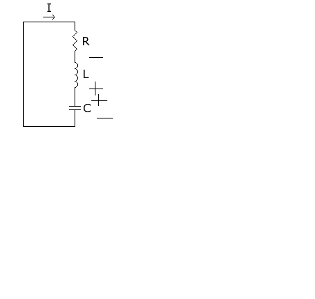

in the attached figure.., let i be in clockwise.
so how can i get di/dt ..
again when battery is removed how can i get di/dt..
cause it is what di/dt that will determine polarity of inductor
in this figure with assumed polarities and current how can i get the corresponding differential equation...?
When you're working from given initial conditions then you need to know something about the properties of the components.
Suppose that you being with the battery disconnected, no charge on the capacitor, and (obviously) no current at all flowing in the circuit. When the battery is first applied, the inductor resists change in current -- no current flows at the very first instant. But the current will be changing, increasing in the 'forward' direction, being driven by the polarity of the battery. This di/dt will cause a voltage to appear across the inductor according to v = L*di/dt. Initially this voltage will be equal in magnitude to the supply voltage.
The capacitor, being initially uncharged, will have zero volts across it at the first instant. As the current begins to flow, it will gradually build up a voltage. Eventually the capacitor will be fully charged with a voltage equal to the supply voltage. No further current will flow. With no current, the voltage across the resistor will be zero. With no change in current (di/dt) the voltage across the inductor will be zero.
You need to state the initial conditions. Is there a current already flowing? Is the capacitor charged? If so, what is the polarity of the voltage on the capacitor?
The initial conditions will determine the 'directions' in which things happen.
