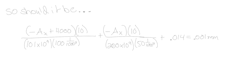

ski0331 said:
No. You need to be careful with your arithmetic: $$-\frac{(A_x+4000)(10)}{(101\times 10^9)(100\times 10^{-6})}-\frac{(A_x)(10)}{(200\times 10^9)(50\times 10^{-6})}+0.018=0.001$$ where ##A_x## is a positive compressive force. What do you get for ##A_x##? What do you get for F from my equation in post #3?

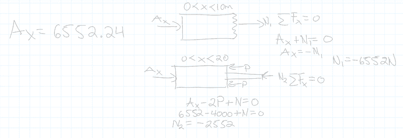

A(x) I got is equal to 6552.24, F=-6552.44
I confirm. I treated F as tension and got a negative number, while you treated it as compression and got a positive number. So this is the compressive force on the steel rod, and the compressive force on the brass rod is 6552+4000=10552 N. What do these solutions to the elastic problem (neglecting the yield stress) give you for the stresses in the brass and the steel?

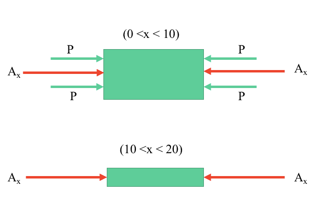

ski0331 said:
ok you lost me on this chart. why are there 4p? 2 ax?
The forces on the left are the reaction forces from the constraint. The 2 P forces on the right are the applied forces. The Ax on the right is the compressive force applied on the brass section by the steel section.
You are aware that tension and compression are bi-directional, arising from the application of the Cauchy stress relationship to determine the forces acting on a surface? You remember from freshman physics the tension in a rope pointing to the right (for the force the material on the right applies to the material on the left), and to the left (for the force the material on the left applies to the material on the right), correct?
yes but Ax is the reaction forces of the wall. In my FBD Ax pushes back on 2p and the Normal force.
Taking each section as a free body, the forces on the two ends of each section must be equal in magnitude and opposite in direction. Otherwise, the sections could not each be in force equilibrium.
An overall force balance on the composite beam tells you that the reaction force on the left boundary has to be ##A_x+2P##.
