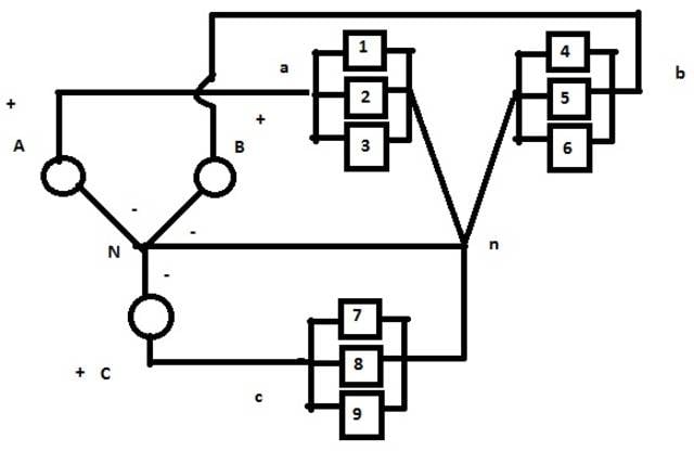

Hi there, I want to know what is the best way to connect these devices to a 3 phase power supply outlet and minimise the unbalanced load as much as possible safely? I am only worried about the single phase appliances. What type of connection would you recommend?
3x Power Supply units Single Phase 10A input
2x Fans Single Phase 2A input each
4x Variable Speed Drive Single Phase, 2 of them will take 6.7A rest two 12.5A
2x VSD 3 phase 10A - 14A
THanks.
If you have any explanations that would be greatly appreciated as well. This is not a homework.
You have single phase devices with these requirements in amps;
10, 10, 10
2, 2
6.7, 6.7, 12.5, 12.5
Total is 72.4A. Divide by three to give ideal 24.1A per phase.
Allocate loads to phases, all with neutral as common.
Try different combinations such as the following;
Ph1: 12.5, 10, 2 = 24.5A
Ph2: 12.5, 10, 2 = 24.5A
Ph3: 6.7, 6.7, 10 = 23.4A
Phases will be matched within 1.1A. Neutral current will be about 1.1A.

Does this mean each of those devices will be connected in series to each of the phases (across line to neutral that is)?
Neutral as common as in connect the loads in Y formation?

Ph1: 12.5,2.3,1.3 = 16.1A
Ph2: 12.5,2,2 = 16.5A
Ph3: 6.7,6.7,2 = 15.4A
Current in neutral = 0.96A
You seem to have got the idea.
Each phase of a three phase system is a single phase supply when considered with the common neutral.

The power supply provides 415V, all the individual devices take 240V.
What I am having trouble understanding is when I connect the selected devices on the line to neutral(across each phase) in series, the current flowing through them is the same but voltage across each will be different. But I want equal voltage across the devices and different current according to the the ratings of them.

What I am having trouble understanding is when I connect the selected devices on the line to neutral(across each phase) in series, the current flowing through them is the same but voltage across each will be different. ...
That's a little tricky to decipher:
Let's take one device at a time for starters.
Connect one end of it to any phase, other end of it to neutral and It'll see 240 volts. It'll accept current in proportion to its load.
Now connect another device but to a different phase, and neutral.
It too will see 240 volts and draw whatever current it needs.
They are NOT in series provided the neutral wire goes back to your three phase source neutral..
Series means they must have same current. These loads don't suffer that constraint, they are free to draw different amounts of current and the current difference will return through the neutral.
So they're NOT in series IF you have a neutral.
Voltage is fixed by the phase to neutral voltage of your supply, 240 volts.
Does your source provide that necessary neutral?

Yes the source has a neutral. It is not an imaginary problem.
I was thinking of connecting the devices in parallel across each phase so they each see the same voltage and draw whatever current they require.
Here is a diagram, let me know what you think
I have several devices in the same phase, hence the question about them being in series
1, 2 and 3 are not in series with one another. Neither are 4, 5 and 6.
As you said each can draw the current it needs.
Devices in series must carry the exact same current by wiring not by chance. 1, 2, and 3 are in parallel with one another. You could replace them with one box labelled 123...
4, 5, and 6 are in parallel with one another. You could replace them with one box labelled 456...
123 is NOT in parallel with 456 for they have different voltage sources.
Devices in parallel must see same exact voltage by wiring not by chance..
123 is NOT in series with 456 because the neutral can return their differing currents .
I think you've got it, though..
