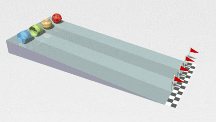

If there is no friction the ball will not rotate either. However, a similar problem involves homogeneous balls and cylinders rolling without slipping vs hollow balls and cylinders doing the same. They have different moments of inertia and will therefore experience different accelerations, see this image from Wikipedia:
Edit: Note that the red sphere is the hollow sphere...
Likes vanhees71 and BvU
