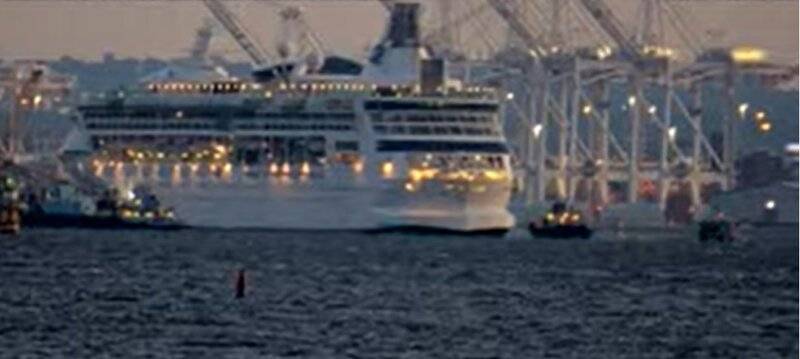

Another propulsion loss situation while leaving port... Also, fuel issues on Dali

  • #147
