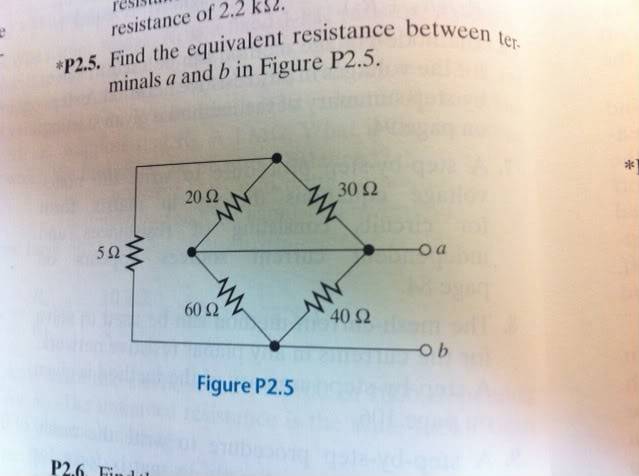

Two questions:
1.
2.
P(power)=V(voltage)*I(current)
P=v^2/R
1/((1/R_1)+(1/R_2)+(1/R_n))
1. I have simplified the bottom two resistors (60[tex]\Omega[/tex], 40[tex]\Omega[/tex]) into one resistor using the equation 1/((1/R_1)+(1/R_2)+(1/R_n)) and have a single resistor of 24[tex]\Omega[/tex]. Then I do the same with the top two (20[tex]\Omega[/tex], 30[tex]\Omega[/tex]) and get a result of 12[tex]\Omega[/tex]. I then combine the 12[tex]\Omega[/tex] and the 5[tex]\Omega[/tex] on the left by simple addition and get 17[tex]\Omega[/tex]. Then, I combine the 17[tex]\Omega[/tex] in parallel with the 24[tex]\Omega[/tex] and get a simplified result of approx 9.95[tex]\Omega[/tex]. I don't believe this to be right, however. My prof states that the answer is 9.6 - so I'm close, but no cigar.

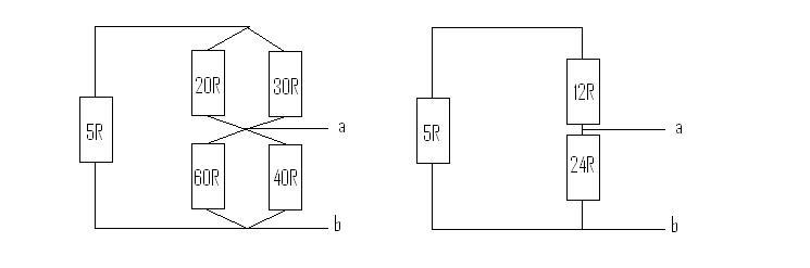

For the first question involving the resistors, all your initial calculations are correct. Why don't you believe them to be correct?
Redrawn image with your numbers in it for clarification.
My prof got 9.6 and I got 9.95 for the R_eq. Really close and I don't know what could be the .3 difference. Thanks for the help, I guess I'll just keep it and argue it if it's wrong.
As for the second one, I'll take another shot at it.
Thanks!
I'd keep your result and ask to see his working to clarify where 'you' went wrong.
Working backwards, 40R||60R = 24R. If 24R||x = 9.6R, then x = 16R. If 5R + y = 16R, then y = 11R, but 20R||30R = 12R, so perhaps he just slipped on the calculator and put in 11R instead of 12R when he was doing that step?

Ok so for question one I found out why I was getting R_eq = 9.9 instead of 9.6 and I've found it is because I have the international edition of the book and the resistor on the left is 4[tex]Omega[/tex] instead of 5[tex]Omega[/tex] - sneaky.
