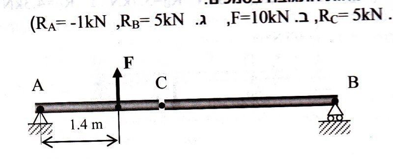

What is the force at the joint C on the right beam?

Pay attention that the left support A is a fixed axis and the right, B, is a free moving axis. C is a joint.
The left beam (to the joint): 2m, 6[kN], the right beam: 3m, 10[kN]. What is the force F.
Moments: ##M=F\cdot L##
To support he right beam 5[kN] must be applied upwards on the joint. moments around A:
$$1.4\cdot F=6\cdot 1+5\cdot 2$$
$$1.4\cdot F=16\rightarrow F=11.43$$
It should be F=10
I assume C is a pinned joint?
It seems to me that there is a mechanism where joint C would need to move up in order to develop a sufficient load from the right side beam for equilibrium.
You may want clarify things and draw a free body diagram with all the reaction forces and beam lengths labeled.
@Karol I get your answer.
I think you'll find that if you change that 1.4m to 1.6m your answers will all be in agreement with the book. :wink:
