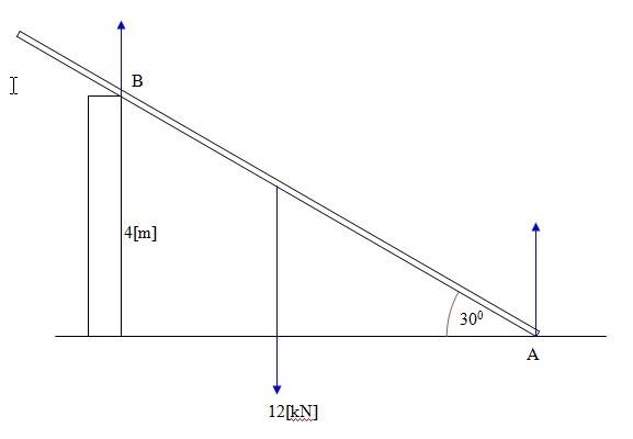

A beam of 12[kN] is on a smooth floor on one side and on a rough edge on the other.
The total length of the beam is 10[m].
What is the reaction on the edge.
Moments (torque): F1L1=F2L2
I drew the forces. the reaction on the floor is vertical and also on the edge since there aren't horizontal forces.
Moments around point A:
$$12[kN]\cdot 5\cdot \cos 30^0=R\cdot\frac{4[m]}{\tan 30^0}\rightarrow R=7.5[kN]$$
In the book it's 6.5, i think it's a mistake
  • Free-body diagram of a beam resting at 30 degrees, with end A on a horizontal floor and end B on a vertical edge 4 m high; vertical reaction arrows at A and B and a 12 [kN] downward load at the midpoint.

I agree with 7.5kN.
Edit: looks like they took the horizontal distance for mg but the distance up the slope for the wall's reaction.
Edit 2: ... are you sure they wanted the total reaction, not just the normal reaction from the wall?
I am almost sure they want the total reaction.
