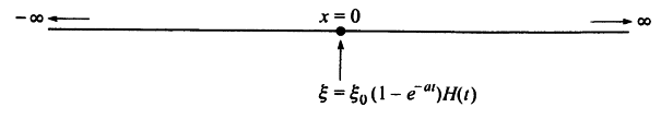

I have a string that's infinite on one side, as well as a string that's infinite on both sides. The displacement at the center (x=0) is the same for both, as shown in the pictures.

Horizontal line representing an infinite string, labelled -∞ at the left end and ∞ at the right end, with a dot at x = 0 and the expression ξ = ξ₀(1 − e^(−at))H(t) written below it.

I think the G term goes to 0 because there's no incoming wave but I'm not sure
Here's my solution for the string that's infinite on one side, would this be any different if the string was infinite on both sides? Maybe not because multiplying by H(t) makes the function zero at negative values of x. I'd appreciate your comments.
Handwritten-style math: xi = F(t) at x = 0, where F(t) = xi0(1 - e^(-at))H(t), then substitution t to (t - x/c) giving xi = xi0(1 - e^(-a(t - x/c)))H(t - x/c).
I also need to graph the strings at a few representative times, and draw the characteristics diagram, so if someone has any suggestions regarding those steps it would be well appreciated. In particular, what times would be representative? And how would I go about drawing the characteristics diagram? Thanks in advance.

Try using words to describe what you expect would happen in each case.
