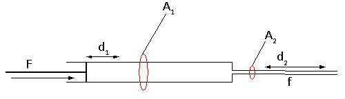

On working on the derivations further (the latest PDF that I attached), I got a few new issues...a very general mechanical issue actually.
If a second piston is attached to the other end of the pipe...it will experience a force f governed by the formula...Since there's a force f there should also be acceleration i.e velocity of the fluid should increase as the force F continuously applies.
But is there any acceleration?

  • #34
dE_logics said:
Is there any acceleration?
That ideal fluid has no friction with the pipe it flows through. If it's not accelerating then no work is done. If the piston at the right end doesn't have an external force being applied, then the ideal fluid moving at constant velocity has zero pressure, and there's no force being applied by either piston. It would be similar to a closed pipe with the fluid inside, moving at constant velocity in space with no external forces.
If you're goal is to turn this into some kind of Bernoulli example, then both pistons need to exert an inwards force to create a pressure on the fluid. If the fluid is flowing and the ends of the pipe and pistons have differing cross sectional areas, then the forces will need to be equal to the fluid pressure times the cross sectional area of the piston surface.

The acceleration here can be taken in 2 ways -
1) The acceleration that occurs when the fluid reaches a narrower cross section form a larger one.
2) An acceleration occurs even when the diameter of the pipe does not change (I'm referring to this one).
So there is an acceleration even in the second case?...practically I don't see so.
The question here is the P in the Bernoulli's equation, I need an explanation as to how it stores energy...and why P is directly taken as energy. By working on this example, I tried to see the same; i.e. if the static pressure is converting to K.E, but actually the work done on the piston is increasing the K.E of the fluid, not the pressure.

In the initial pipe configuration, the static pressure on the right side is higher than the static pressure on the left. This does not mean the fluid is flowing from a lower pressure towards a higher pressure, since the total pressure is the same at every point.
Fluids flow is by difference in static pressure.

Ok, why not just remove modern physics from the picture...this is the classical physics forum...so here an ideal fluid will not violate any physics laws.
in an environment where no work is done.
I absolutely did not put that in the picture.
So, suppose the fluid gains an inertia, and then the force stops acting; then the fluid will flow out of such a pipe -
without any more force application?
That means, if there is a continuous force application as in this case -
There will be a constant acceleration?

The simple question here is that suppose the fluid inside the first tube has inertia twards the right (the tube is not infinitely long, i.e it has a limited amount of fluid in it) will all the fluid easily pass out of the thinner cross section following Bernoulli's equation?
Yes, assuming the fluid is ideal and there is zero gravity. Of course a real fluid is not ideal.
I'm questioning the theory (of Bernoulli's equation)
How can static pressure of an ideal fluid store energy? The microscopic particles in an ideal fluid have kinetic energy. No energy or momentum is lost when the particles collide within an ideal fluid. The kinetic theory of ideal gases is a good place to study this conceptual model.
When a force acts at one end of an ideal fluid, it sees the total mass of the fluid, so the acceleration in many cases is relatively small. The piston accelerates quite slowly. The pressure is transmitted instantaneously in an ideal fluid and therefore Bernoulli's law is a reasonable approximation anyway. This is like the voltage spike on an inductor with zero starting current flow, a long pipe full of fluid is like an inductor in a circuit analogy when applying the pressure-voltage analogue.

When you said this in the OP:
...considering an ideal fluid in this situation...
...you were invoking the incompressible flow simplifying assumption (as well as inviscid, steady, lossless, and no heat transfer assumptions). How could you not know that? Didn't you know that there is a version of Bernoulli's equation that does not assume incompressible flow? Did you not read the wiki on the subject?
This is why I said in post #29 that the entire key to this thread is that you don't understand the purpose and scope of simplifying assumptions...
1) Bernoulli's principal* assumes an ideal fluid and the fact that pressure can store energy...how can an ideal fluid store energy in terms of static pressure?
This is the only problem with Bernoulli's equation I'm having...
I answered this directly, already: the incompressible flow form of Bernoulli's equation only assumes no change in density. You are equating the incompressible flow assumption with an assumption that static pressure can't store energy. It does not assume that static pressure can't store energy. You can see that in the equation!
*And agin, Bernoulli's principle DOES NOT assume an ideal fluid. A particular form of Bernoulli's equation might, though.
You need to stop doing that. You need to stop with making these diagrams and inventing situations to try to prove physical theories wrong. You don't understand Bernoulli's principle anywhere near well enough to challenge it and you're meandering around with lines of thought that don't have anything to do with Bernoulli's principle. This is why you are having so much trouble here (and why people are getting frustrated with you): You are not really trying to learn.
Since you clearly didn't read it, here's the opening two paragraphs from the wiki on the subject. Read them!
In fluid dynamics, Bernoulli's principle states that for an inviscid flow, an increase in the speed of the fluid occurs simultaneously with a decrease in pressure or a decrease in the fluid's potential energy.[1][2] Bernoulli's principle is named after the Dutch-Swiss mathematician Daniel Bernoulli who published his principle in his book Hydrodynamica in 1738.[3]
Bernoulli's principle can be applied to various types of fluid flow, resulting in what is loosely denoted as Bernoulli's equation. In fact, there are different forms of the Bernoulli equation for different types of flow. The simple form of Bernoulli's principle is valid for incompressible flows (e.g. most liquid flows) and also for compressible flows (e.g. gases) moving at low Mach numbers. More advanced forms may in some cases be applied to compressible flows at higher Mach numbers (see the derivations of the Bernoulli equation).
The phrase "inertia towards the right" is gibberish. I don't think you understand what the word "inertia" means...
...perhaps the word you are looking for is momentum?
Bernoulli's principle doesn't work in empty pipes, only full pipes.
...will all the fluid easily pass out of the thinner cross section following Bernoulli's equation?
What does "easily" mean?
That line of questioning is incoherent.
Except that once there is no inwards force from the pistons, the pressure drops to zero. Each piston need to exert some exact amount of force to maintain a constant mass flow rate within the pipe. As you pointed out earlier, this occurs when the there is no net work done on the fluid.
  • #57
russ_watters said:
You are misusing the word "inertia", so the question is meaningless (perhaps you mean "momentum"?). Please rephrase.
Also, Bernoulli's principle and equation don't deal with partially empty pipes, nor does it deal with unsteady (accelerating) flow. So your question doesn't seem to me to have anything to do with Bernoulli's principle.
I meant momentum.
What actually do you mean by partially empty?...vertically (i.e the whole cross section of the pipe is not filled) or horizontally (the whole pipe is not filled along it's length, but filled along it's cross section)?
So, the answer is no, there has to be a constant force application to make all the fluid flow out...but it's not a function of how much force...even the slightest force will be good enough to make all the fluid flow out.

  • #60
If the fluid is air, the air will spread out to fill the pipe due to its own pressure. This will happen whether you are applying a force to it or not. The far end can't just stay a vacuum.
If the fluid is water and there is air at the end of the pipe, the water will spill out and the air will move backwards to fill the pipe.
Also, this "force" has to come from somewhere. If you have a piston, for example, and you stop moving the piston, the air or water will have to stop too, otherwise you'll generate a vacuum where it meets the piston.
Ehh, water in an unfilled pipe with air on each end will gain momentum that will carry it for a while if you ram it with a piston (then somehow remove the piston and let air in that end). But again, these things have bear no relationship to the scenarios described by Bernoulli's principle and your description is not detailed enough for us to know what your scenarios are really trying to describe. You can't just draw an arrow and say there is a force. You need to be more specific about what is causing the force and how it can just go away.
I really have no idea what you are trying to describe with that first diagram. For the second diagram, the system will accelerate and quickly reach an equilibrium with steady flow, based on the applied pressure equalling the total pressure required to move the fluid at a certain velocity through the small pipe.
