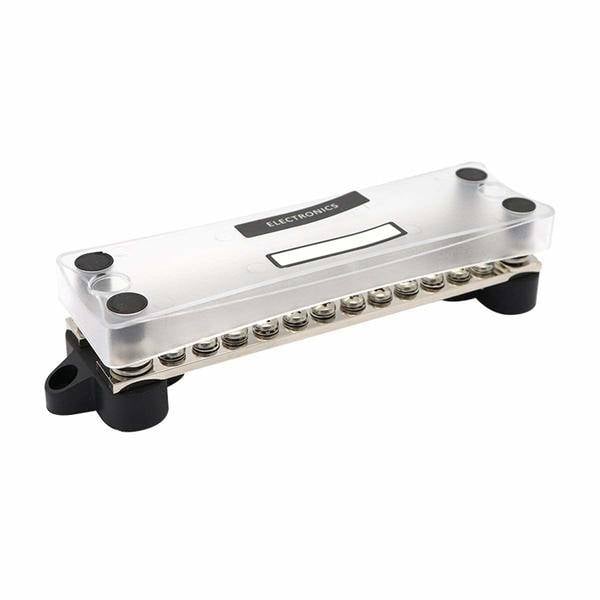

Okay this may seem like a basic question. I was wondering what would be the best way to connect 8 wires to a single wire. Here's a simple diagram that shows what I'm trying to do:
I've been looking around and I've found things like this:
Although it seems that there is no larger one that can support 8 wires. What is the correct way to attach multiple wires together? Should I just daisy chain multiple of these, or is there a better way?

I've usually used the terminal strips with jumpers on one side for stuff like this, as they are cheap and available.
Another alternative is a buss bar.
Or a terminal block

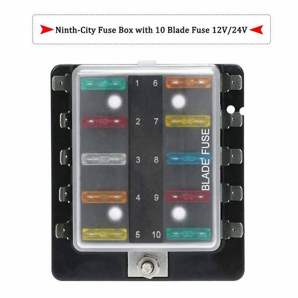

Or a fuse block, if you need to protect the relay parts.

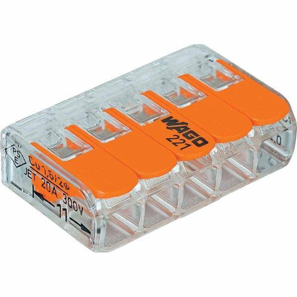

You can also look at some of the connector systems from Wago. We use their spring-locking splices (like 222-415) for a lot of our AC Mains prototype quick-connects:
