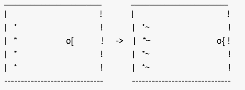

I thought about gloves with metal parts distributed along the glove, then when it would pass a defined place or line a magnet or magnet towers or something similar would pull from behind. something like a mime if you may
so:
* = magnets deactivated
* = magnets activated
! = limit line
o[ = person with gloves deactivated
o{ =person with gloves activated
Using magnets can be problematic, because it's way too easy to demagnetize people's credit cards, etc. You could make a mechanical harness that fits to the user's body that has arms that reach out to the hands and provide a counter-force, I suppose...

hm, that's one of the things i thought about too, it would also be using a computer and I am not sure how much that would affect it. That second option was also an option i thought of but i wanted it to be as little invasive as possible.
putting the credit cards aside, if it was under a controlled environment with just a person, a computer and gloves do you think the magnets would work?
I wouldn't think so. If you just have metal parts in the gloves, they will always be attracted to the wall magnets, which is the opposite of what you want. If you try to put magnets in the gloves and point the opposite polarity toward the wall magnet, that will for for a fraction of a second until the gloves spin around and yank the user's hands toward the wall magnets.
If you try to use an AC magnetic field and eddy currents to push the metal in the gloves away, that will create some serious heating issues in the gloves.
You may not be able to, but can you say more about the application? There may be some other options that would be more viable. :smile:
