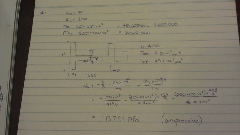

Where is the point of maximum compressive stress in bi-axial bending?

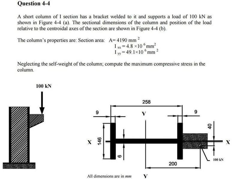

Hi all,
I've attempted this question however my solution seems too simple..? I have taken the point 'A' (bottom right corner of beam) as the point with max compressive stress, I am not sure if this is correct. I have just assumed this by observation.
Everything looks OK. You caught the typo in the units for the moments of inertia; very good.
Likes DrVirz
Well that's great news! For some reason I thought my solution seemed to simple!
Thanks for clearing that up!
