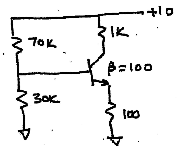

This is the solution given:
VB = (VCC*30k)/(70k+30k) = 3V
Why is a voltage divider being used to find Vb?
Your question should be in the problem statement, not the attempt.
Are you sure that VB is the same as Vb? Looks to me like a determination of a Thevenin equivalent for the base voltage supply. Was there also a Thevenin resistance calculated (paralleling the 30 k and 70 k resistors)?
VB is Vb.
Thevenin resistance was calculated for 30k and 70k.
What is your task? To find the DC voltage VB at the base?
Don`t forget that you have a loaded resistive voltage divider - loaded with the transistor base current.
This is what I imagine the author of the solution was going for:
With ##V_B## and ##R_B## being determined as the Thevenin equivalent of the base voltage divider.
