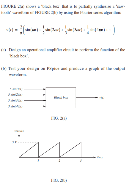

FIGURE 2(a) shows a ‘black box’ that is to partially synthesise a ‘sawtooth’ waveform of FIGURE 2(b) by using the Fourier series
algorithm:
v(t) = 2/pi(sin.omega.t)
Hi
I received some great help yesterday and i was hoping someone would be able to help me out again today
Note: the given equation is very long and would look very messy without being typed in the correct format so I didn't enter the entire thing in the relevant equations box; instead it is included in the screenshot below
I am not sure at all what is being asked of me here. There are no Fourier algorithms in any of my notes so I am struggling with what I can do with this.
What I know so far is that the amplitude is 5 volts, and the frequency is 1000hz (1 cycle per ms on the graph).
Could someone please explain how I should use the Fourier algorithm to find my answer?

Step back a bit and take a broader look at it.
The sine functions are already given as inputs to the box. The "formula" is a weighted sum of them...

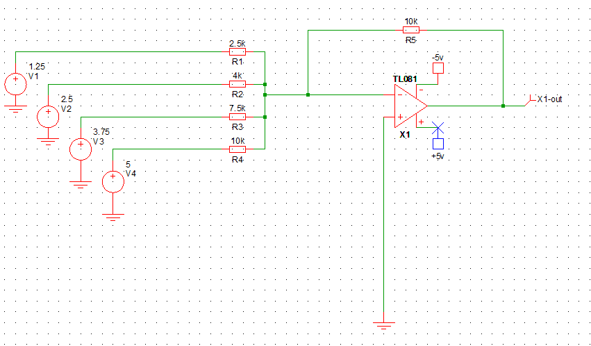

this is my schematic so far with those gains, but it doesn't have the correct waveform yet
The input voltages should all have an amplitude of 5V, since those are the inputs to your block. And this is still an inverting topology, so to get the correct waveform you will need to invert the output (and maybe add an offset?)... Oh, and you will need wider power supply rails than just +/-5V, especially with a TL081 opamp -- Can you say why? :smile:

Yeah, it's definitely not a rail-to-rail opamp, but it should be fine for this simulation. I'd just set its rails to +/-15V to give plenty of headroom.
I changed this now - I am just learning about op-amps now so I will make many more of these silly mistakes, unfortunately!

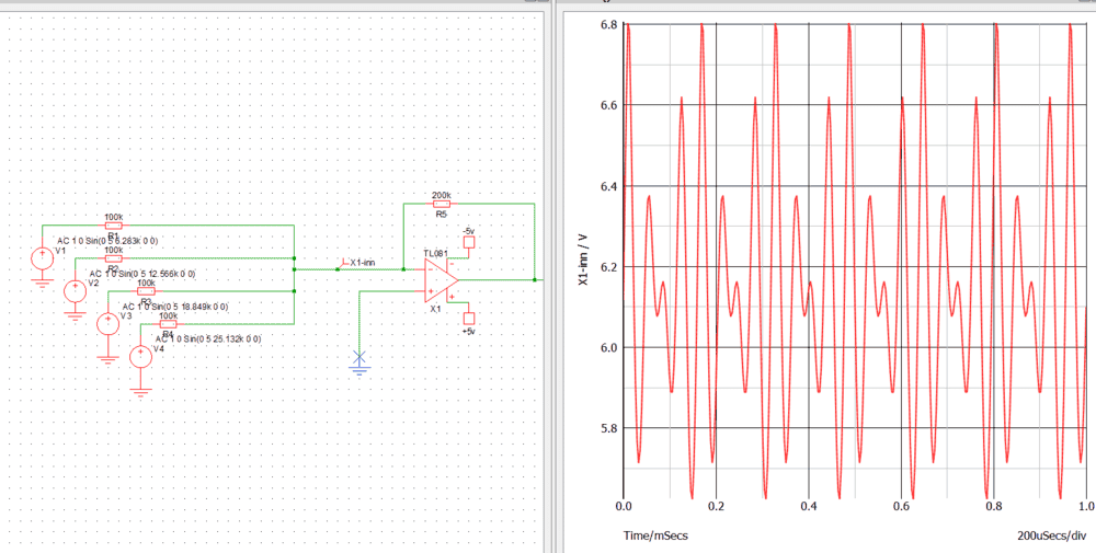

I changed that, and flipped the op-amp around, but I get nothing like what I am looking for. I added a dc offset at the inverting terminal.
I feel like I am way out of my depth with this right now :(

Can you post your updated schematic? And be careful -- the gain of a non-inverting summing stage is different from that of an inverting stage...
Offset is set to -6 right now but I've just been messing around with different values for it for now
just editing to add - op amp rail supply is now +- 15, i just forgot to change the name of the terminals

The gains for each component (sin waves of different frequencies) are given in your first post as the Fourier Series coefficients...
I see - so those 4 voltages I calculated from the sin functions earlier should be how I calculate the gains i need?
i.e. 5/1.25
5/2.5
5/3.75
and 5/5 ?

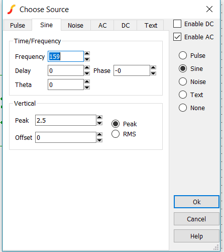

Something like that. Once you get the sawtooth waveform, you can fine tune the coefficients to get the 2.5V peak amplitude (plus remember to include the 2.5V constant offset term, both in the FW (which they omitted in the problem statement) and in your opamp circuit).
These need to be AC supplies with set frequencies right? otherwise i'll never get a waveform
