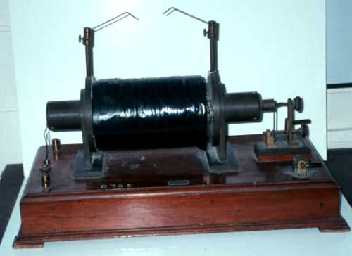

An induction coil is one of these:
They had a primative rattling switching contact mechanism to provide the varying flux.
These contacts were unreliable, but the coils themselves were beautifully made and lasted for ever.
They are mainly seen in schools and are still available. An easy way to produce scary sparks.

The induction coil in the picture above has a piece of soft iron being attracted to the core of the transformer when DC passes through it. This switches the DC supply to the coil off and the cycle repeats.
For some reason this seems to be added as an afterthought and it is usually noisy and erratic.
Ideal machine for instilling a sense of shock and awe into students, though.
