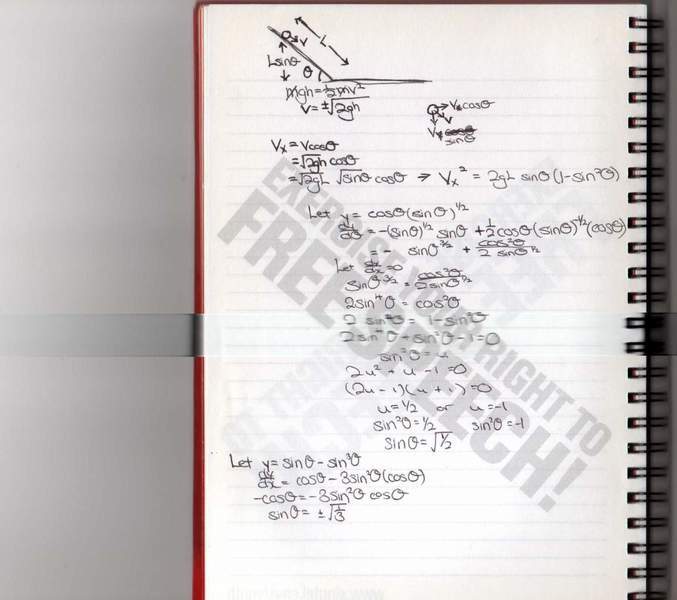

During my lab i have to roll a marble down a ramp at different angle. I am required to calculate the angle between the ramp and the table so that the marble will achieve the maximum speed when it slide off the ramp.
mgh=1/2 mv^2
V(in x direction) = Vcosx where V is the velocity of the marble and x is the angle of the ramp to the table.
I equate the 2 equations together and gotten V(in x direction) =(cos x )sqrt 2gh
where h=LsinX. So i equate (cosX)sqrt(sinX)=y and differentiate once and equate to 0. The answer i got was X=45 which is wrong. However, if i change the equation to V^2=2gL(sinX)(cosX)^2, the angle i got was arcsin (1/sqrt3) which is about 35. Why is this so??

OK. So you want to maximize the horizontal component of the speed, not the speed itself. The way you phrased the question initially is confusing. Look at it this way, the speed at the end of the incline is going to be
v = \sqrt{2gh} =\sqrt{2gLsin\theta} where L is the length of the ramp.
The horizontal component of the velocity is
v_{x} = v cos\theta =(\sqrt{2gLsin\theta})cos\theta
So the problem becomes finding the value of θ for which
cos\theta \sqrt{sin\theta}
is a maximum. Without the radical it would be 45o. With the radical it's something else. Can you find what?

I know what the angle is. I am just asking why is it that when i calculate the maximum value for theta using v=(\sqrt{ sin\theta})cos\theta the answer is 45 but when i square the equation and solve for theta i can get the correct value for theta. Don't mind going through my working in the file attached and tell me which part i did wrongly.

semc;2316257[B said:
]I know what the angle is. I am just asking why is it that when i calculate the maximum value for theta using v=(\sqrt{ sin\theta})cos\theta the answer is 45 but when i square the equation and solve for theta i can get the correct value for theta. Don't mind going
When simplify
sin^3/2(θ) = cos^2(θ)/2sin^1/2(θ)
it becomes
2sin^2(θ) = cos^2(θ)
the marble also have rotational kinetic energy
Indeed it does. The kinetic energy at the bottom will be
K=\frac{1}{2}*\frac{7}{5}m v^{2}
Clearly, including the 7/5 correction due to rotational energy reduces the linear speed at the bottom but does not change the angle at which the horizontal component of the linear velocity is a maximum.
