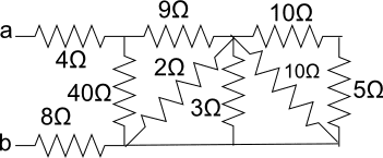

Calculate equivalent resistor
Req=(10 series 5)//(10)//(3)//(2)//(9 series 40) series 8//(4)
I am not sure in the bolded text, is 9Ω connected serially with 40Ω.
