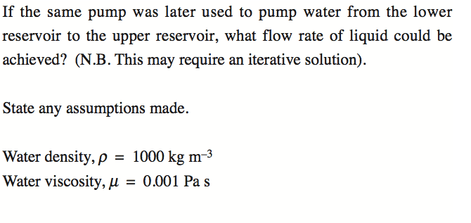

I am trying to calculate the flow in a system from an underground tank up through a pump into a vessel.
But cannot find or derive a formula that yields a good result, I don't think I can use the same head calculations as Velocity will have changed.

Why did you choose 2000 for Re?
From my notes this equation looked to give a reasonable answer. It however finds the Critical Velocity, which I now see is the velocity in which the flow changes into turbulent flow.
I used 2000, as I know from a previous question using the exact same system but given a flow, different Viscosity and density, that the pipework is laminar.
Is there a way to transpose the old Viscosity and density with the new one to find flow or velocity?
I am told the solution may require an iterative solution.
Thanks
Suppose, instead of knowing the power supplied to the pump, you knew in advance the velocity of the flow in the pipe. Could you then solve for the power supplied to the pump?
The question states using the same pump as before. So I think I need to use the power previously stated and work backwards to velocity and hence flow.

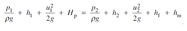

Given Fluid information and heads calculated from Velocity. Using Darcy Formula
Good. Do it. Let's see what you get for the power.
So I calculated Flow to be ##0.0019m^3s##
Hm = 0.023m
Hf = 1.97m
Therefore using Darcys Equation is ended up with Hp to be 29.18 (very similar to my previous fluid)
Which gave me a Power of 858 kW.
From this I assume that Hp won't change much in this given system.
Hence from my first question. ##Q= \frac {2749} {1000*9.81*29.19} ##
Thanks
Do you really mean kW?
In your equation, what does hm stand for?

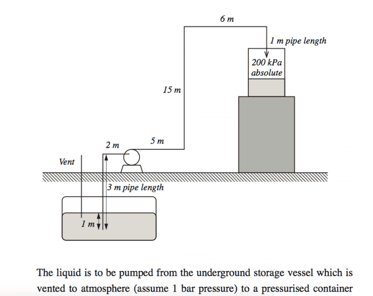

Is there a diagram of the system?

Hm stands for the frictional losses caused by fittings. Though I'm now looking thinking my overall process for Hf is incorrect.

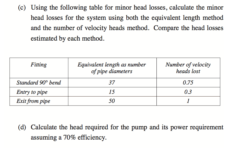

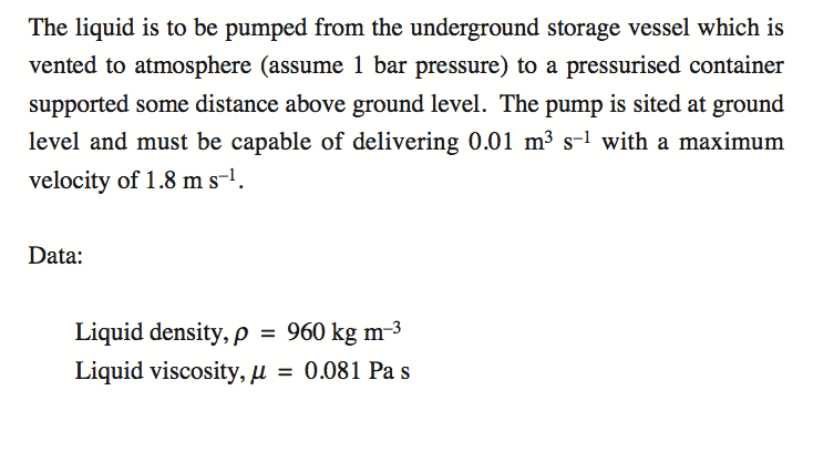

Can you please provide the entire problem statement. Thanks.
Initial parts
That was the original
Issue we started with.
For a velocity of 3 m/s, I get a volumetric flow rate (assuming a diameter of 0.09 m) of 0.0191m^3/s. Is this what you got?
I get a mass flow rate of 19.1 kg/sec.
I get a Reynolds number of 270000. Is this what you get?
For a smooth pipe, I get a Darcy Weisbach friction factor of about 0.15. Is this what you got?
I get a velocity head of 0.459 m.
I get a frictional head of about 24.5 m. Is this what you get?
The pressure head and the gravitational head are both independent of flow rate.
Pressure head = 1 bar = 10 m
Gravitational head = 16 m
Is this your assessment?

I think my frictional head loss is 23.29 as I was going from the water surface not the whole leg i.e. 17m height.
GSXR-750 said:
Thanks for you patience with me
I got the Flow rate, mass flow rate, Reynolds and velocity head. I don't believe i have studied finding the Darcy Weisback friction factor.
Then you must be using Fanning. Darcy Weisback friction factor is 4 x Fanning, and, in the DW equation, you only use L/D, compared with than 4L/D with Fanning.
The frictional head should be based on the total length of pipe, 32 meters.
