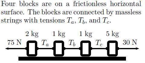

The discussion revolves around calculating the tension Tc in a system of four blocks on a frictionless surface connected by massless strings. The initial attempts at solving the problem yielded tensions of 25N and 35N for Tc, but these were incorrect. Participants emphasize the importance of determining the acceleration of the blocks to find the correct tension. A hint is provided to focus on calculating the acceleration as a crucial step in solving for Tc. The conversation highlights the need for a clear understanding of the forces at play in the system.

Four blocks are on a frictionless horizontal
surface. The blocks are connected by massless
strings with tensions Ta, Tb, and Tc.
Calculate the tension Tc.
Answer in units of N.
F = ma
Fn = mg
Tc1 = 25N
Tc2 = 35N
Hi allora_97! :smile:
allora_97 said:
Tc1 = 25N
Tc2 = 35N
No.
Hint: what is the acceleration? :wink:
