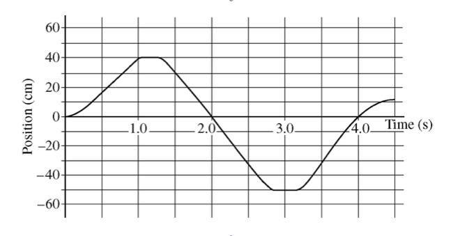

What is the velocity of the object at t=2.5 s?
Please see attached graph.
v = d / t
v = -30cm / 2.5 s = -12cm/s
key gives correct answer as -60cm/s, but I can't figure out how to get that answer. Please help!

Hi twalk353! Welcome to PhysicsForums :smile:
To find the velocity, you need to find the slope of the curve at that point. How would you do it?
Hi Infinitum! Thank you...
Eureka! That simple...I knew I was over looking some thing very easy.
slope = rise / run -or- y2-y1 / x2-x1
(x1,y1) could be (1.5,30) or (2,0) and (x2,y2) could be (2.5,30)
Then plug in...
-30-0 / 2.5-2 = -60cm/s!
Thank you for your help!
