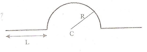

For a picture of the problem, look at the attached picture.
There's a current i through the wire.
1)Calculate the magnetic field (at point C) produced by each segment of length L.
2)The semi-circular segment of radius R.
3)The entire wire.
None given. Biot-Savart and Ampère's law.
1)Using Biot-Savart law, I have that \vec B = \frac{\mu _0 i}{4 \pi} \int d \vec l \times \frac{\vec r}{r^3} but \vec l and \vec r are parallel, so the cross product is worth 0 and so the contribution of the 2 segments of length L to the magnetic field at point C is null.
2) and 3) : Using Ampère's law I get that B=\frac{\mu _0 i}{\pi R}
Is that right? I find my answer to 1) strange.
Your answer to 1) is right: charges moving directly towards or away from a point don't induce any magnetic field at that point. Your answer to 2) is a bit strange, though. How did you use Ampere's law? Which closed loop did you integrate around? I find it easier to just use the Biot-Savart law; the integral isn't necessary because the vector dl is always perpendicular to the vector r.
Thank you very much for helping!
Ok, nice to know I got part 1) right.
2) \oint \vec B d \vec l = \mu _0i but as you pointed out \vec B \perp \vec l for the entire semi circle loop so that B \cdot \pi R = \mu _0 i, hence my result.
I can say I've took a surrounding to the semi circle loop, closed loop. Does it matter? The current enclosed will always be worth i.

There are a few problems with this. First, there's no obvious symmetry that suggests B is the same along the entire loop. Second, even if B doesn't vary, you're trying to find the magnetic field at point C; finding the field along the loop doesn't help. Third, i represents the current enclosed within the loop; in your scenario, the current is flowing parallel to the loop you chose. Finally, you chose a semi-circle, not a closed loop. Ampere's law only works for closed loops (notice the circle on the integral sign in your equation). There are absolutely no exceptions.

hmm I don't understand why not. The semi-circular loop is the only part of the wire that create the magnetic field at point C, so enclosing it by a loop sounded good to me.
I haven't been clear enough. :shy: sorry. I meant I can say I have chosen a closed loop which has the same shape as the semi-circular part of the wire. For example a loop that has a width of \varepsilon arbitrary small or big, instead of no width as is considered the wire. But a closed loop that enclose absolutely all the semi-circular wire.
Lastly, I will see a friend today, I will ask him if he knows how to solve this problem. I will post back here anyway, whether or not I have to procedure to solve the problem. Answer to my misconception if you like though, I'd be glad to learn.
As ideasrule states, Ampere's law is not useful in solving this problem. Instead, use the Biot-Savart law for all parts of the problem. The integration is trivial.
You're right, I've underestimated this part.
\vec B = \frac{\mu _0 i}{4 \pi} \oint d\vec l \times \frac{d \vec r}{r^3} but as \vec l \perp \vec r, the path integral is worth \frac{\pi R}{R^2}=\frac{\pi}{R}, thus B= \frac{\mu _0 i}{4 R}.
The direction of the magnetic field must point upward C, I believe. (for symmetrical reasons).
I hope I got it right.
Looks good. (The direction of the field depends on the direction of the current. It's either into or out of the paper.)
