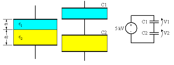

The insulation in a plate capacitor consists of two layers with the thickness of 1 and 2 mm, and a relative permittivity of 4 and 6. Calculate the field strength in the thinnest layer when the capacitor is connected to a voltage of 5000v.

A capacitor with multiple layers of dielectrics can be modeled as a series of capacitors, one for each layer. As a suggestion, start with the formula for the capacitance of a parallel plate capacitor and think "voltage divider".

The distance between plates is set by the thickness of the dielectrics. Assume the same plate area for all, and represent it by a variable. It'll cancel out, so no worries.
You must have seen the formula for the capacitance of a parallel plate capacitor:
$$C = \epsilon \epsilon_o \frac{A}{d}$$
where ##\epsilon## is the relative permittivity, A the plate area, and d the plate separation. You're given the thicknesses of each capacitor. So write expressions for the capacitance of each capacitor leaving A as an unknown.
If you consider the equivalent circuit (far right of above figure) you should be able to see that there's a capacitive voltage divider. Can you write an expression for the voltage across the thinner capacitor (C1)? Then you'll have the simpler case of one capacitor with dielectric and potential difference to deal with.

A is an unknown that will eventually disappear once you've written the voltage divider expression. C is the capacitance of the individual capacitors and is what you want to write the expressions for using your equation above. d is the distance between plates. The d's for each capacitor are given to you in the problem statement as the thicknesses of the dielectric layers.

Suppose that the thinner capacitor is called C1 and the other C2. Write the voltage divider expression for the voltage across C1.
Then substitute your capacitance expressions for C1 and C2. Simplify.

Each capacitor has its own d. It's the thickness of its dielectric. That should be apparent from the diagram I posted above.
ε0 is not 1. It's the permittivity of free space (vacuum) with units of Farads per meter, so
$$\epsilon_o = 8.854 \times 10^{-12} F/m$$
But it, too, will cancel out just like the A's. Your voltage divider expression is nearly correct, but you need to include the voltage being divided and use the supplied values for the distances.

I now have VC1 = [itex]\frac{4*\frac{A}{0.001m}}{4*\frac{A}{0.001m}+6*\frac{A}{0.002m}}[/itex] * 5000V = 2857.143 V/m(?)

Yup. The output of a voltage divider is volts, not volts per meter. Voltage is the potential difference across C1.
But assuming this is correct, I now know C and the voltage across C. How do I use this new-found insight to calculate E?
What you know is the potential difference in volts and the distance between the plates. Well, you had a formula before that related potential difference to field strength and distance...

V = Ed is the one - hopfully!
So I have that E = V/d = 2857V/0.001m = ##2.86*10^6## V/m.

Yes, that looks good.
