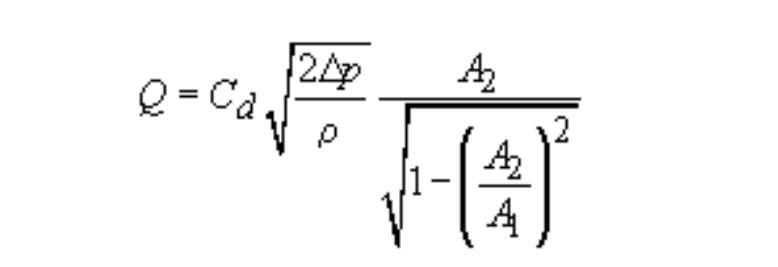

Hello all
I was hooping someone could help shed some light on the following:-
I have the equation shown below:
This equation relates to flow rates of fluids.
I know:-
Q = flow rate
A1 & A2 = Area
Delta h = Difference in Head Loss
g = Gravity
But what does C relate to or even mean?
Can anyone working in the field of hydro engineering or working with fluid flow help?
Thank you.
It looks a lot like this orifice flow equation:
Which is derived here: https://www.efunda.com/formulae/fluids/calc_orifice_flowmeter.cfm. I have not gone through the derivation myself, so don't know if swapping A1 and A2 changes it to match yours. Yours has head loss, which is equal to ##\Delta p / \rho##. The ##C_d## would be the discharge coefficient. Good search terms are orifice flow equation and orifice discharge coefficient.

And THE definitive source: ASME Fluid Meters Their Theory and Application. It's 273 pages of more than most people ever want to know about orifice, venturi, and other types of fluid meters.
Any of the above references is a better, and more complete, source of orifice flowmeter information than any of the web sites that I found. It makes a difference whether the flow is incompressible, compressible, or sonic. And these sources go into the details of which equation to use in each case.
Nitpick: It's head loss or pressure drop or pressure difference, but not difference in head loss.
