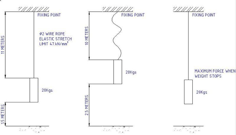

OK here goes...
I have a 20kg weight attached to a 10 meter long wire rope.
The rope is fixed vertically to a cross beam.
The rope has an elastic stretch limit of 47.5 kN/mm^2.
If I lift the 20kg weight up 1 meter and then let it go what would the maximum force exerted by weight be on the wire rope?
It's been a very very long time since I studied Newton so forgive me if I'm barking loudly up the wrong tree!
I started of with Potential Energy = Mass X Gravity X Height but this didn't seem to cut the mustard so I then went for:
Elastic Potential Energy = 1/2 x (k Spring Constant) x (L Spring Length)^2
But I'm not sure if this is the correct equation to use...
Impulse = (Mass x Velocity Initial) - (Mass x Velocity Final)
Which again doesn't seem right but maybe I'm getting confused...
Tension = Mass x Gravity x SQRT(2xHeight/Length Increase)
So I have a selection of formulas that I think I should be using but I don't think I have the correct data to complete the formulas.
So this is what I came up with but I don't really know if I'm going along the right lines or not.
Velocity = sqrt 2 x9.81x1 = 4.429446918 m/s
Potential Energy = 20x9.81x1 = 196.2 Joules
Momentum = 20 x 4.429446918 = 88.58893836kg m /s
Force = Change in Momentum / Time = 88.58893836 / 0.1 Second = 885.8893836
So just how far wide of the mark am I?
