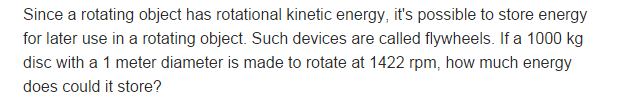

I assume the energy stored is = 1/2 (I) (ω^2)
I (moment of inertia) is MR^2 since it's a hoop? or is it a solid cylinder?
do we need to convert the rpm (revolutions per minute) to radians per sec?
You're on the right track, just realize that a disc is a cylinder with vanishing height.
Otherwise yeah, try it out and report back on what you end up with. It'll be important to do a sanity check on the answer that you get - that'll tell you whether you got the right answer or not most of the time.
No, that's a thin disk. A disk is a solid cylinder.
As you defined it, ω is angular velocity, which is typically measured in radians per second.
Sorry, I should have been explicit - I meant a solid cylinder.
after doing all the math, answer came out to be 1.4 x 10^6 Js.
So right away there's something wrong - the units should be J not J##\cdot##s, unless you meant Joules :P
Does that answer make sense? In the context of the problem, does that seem reasonable?
yes, i meant joules.
Seems too low. Check your conversion from revolutions to radians.
