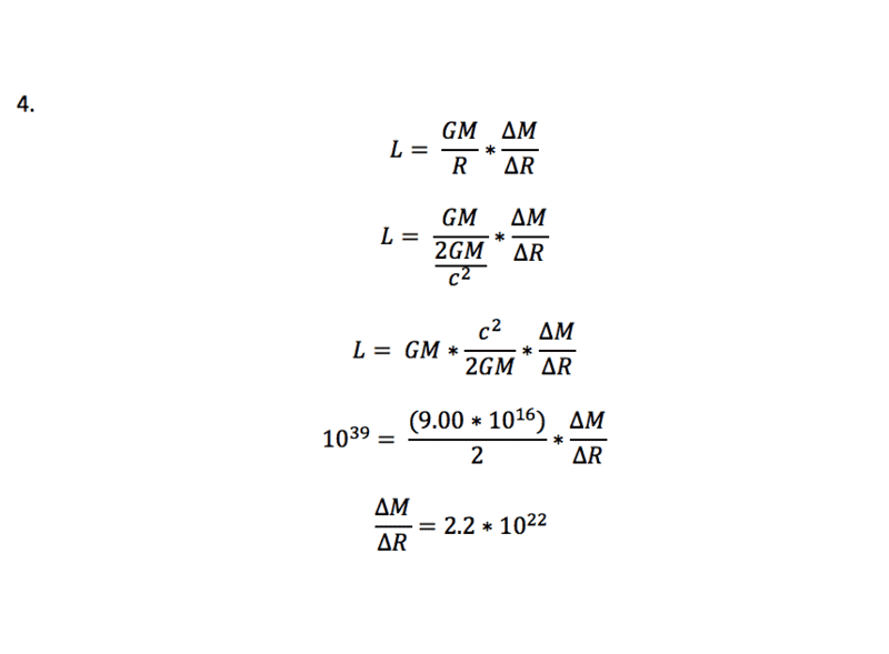

L = GM/R * deltaM/deltaR
So far I can find deltaM/deltaR like the professor said we should. I am having trouble understanding where we go from there.
Perhaps you can expound a bit upon what deltaM and deltaR are, and how you have found them?
I assumed that I am able to plug in the schwarzschild radius for the radius, G is a constant, and I am given the luminosity and mass. When I plug those in I can solve for deltaM and deltaR (which is the rate of accretion).
Can you show the algebra that you did, plugging the Schwarzschild radius into your luminosity equation?
Okay. Now what are the units on your ΔM/ΔR value?
