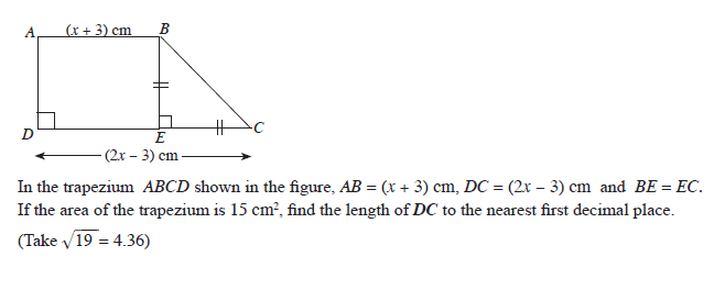

AB = (x + 3) cm, DC = (2x − 3) cm and BE = EC.
area of the trapezium is 15 cm^2 \therefore,(x + 3) (2x − 3) or ? i think you should find the are and use the squarootcan you help me to proceed.
  • Geometry figure of trapezium ABCD with right angles at A and D, top side AB labelled (x + 3) cm, bottom side DC labelled (2x - 3) cm, and point E on DC where BE = EC marked, with text giving the area as 15 cm² and asking for DC to one decimal place.
Not even close.
The formula for the area of a trapezium is $\displaystyle \begin{align*} A = \frac{1}{2}\,\left( a + b \right) \,h \end{align*}$, where a and b are the parallel sides and h is the height.
Can you get an expression for the height in terms of x?
