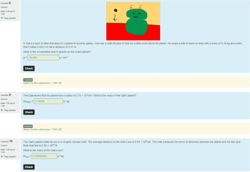

Question: A Gak it a type of alien that lives on a planet in another galaxy. One day a Gak decides to find out a little more about his planet. He drops a ball (it starts at rest) with a mass of 6.18 kg and notes that it takes 0.928 s to fall a distance of 8.37 m.
The Gak’s planet orbits its sun in a roughly circular orbit. The average distance to the Gak’s sun is 6.85 × 10^8 km. The Gak measures the force of attraction between his planet and his Sun and finds that this is 2.89 × 10^20 N.
How long is a year on the Gak’s planet?My Attempt:

And this is apparently wrong...
Can someone tell me what I did wrong? I'm starting to suspect that R didn't include the radius of the planets and I might need to add it in... I've attached the quiz for reference.
