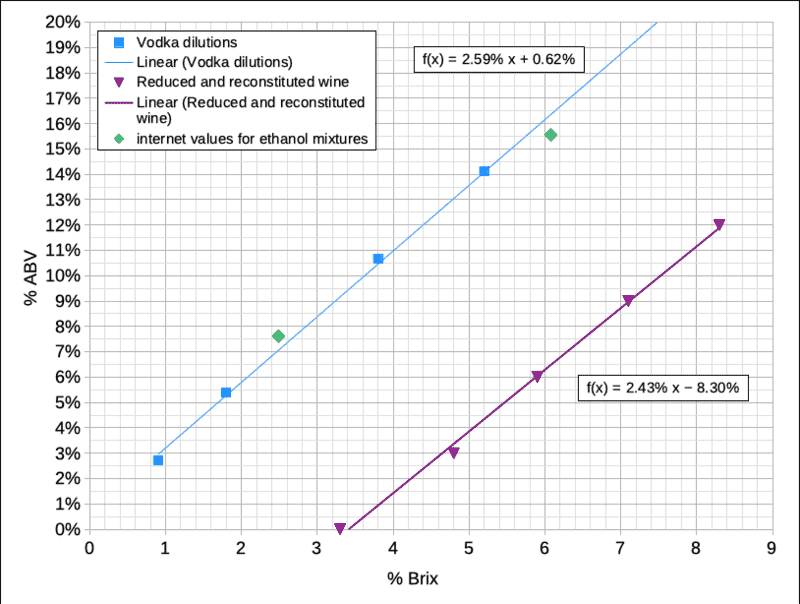

I received the digital refractometer on Thurs. Yesterday, I attempted the calibration of the unit. It's a simple procedure requiring only 2-3 drops of distilled water, then press the cal button. Should return 0.0% ABV on the display. Instead the unit returned different error messages on subsequent cal attempts. I'll try again today to cal the unit. If no success, I'll return it for a replacement.

We have a number of bottles of wine that have gone off the cliff, so to speak. Usually still drinkable but some years past their prime. I use them in spaghetti sauce. I pulled one of those out and measured 250g into a large sauce pan. After 25 minutes at 60-90°C (I wasn't being especially careful) it had reduced to 108g.
I have an inexpensive optical refractometer that I purchased for $25 from amazon to make crude measurements of my espresso coffee concentration. I have tested it against a more accurate method and found it's good to about ±0.2% Brix, if I'm careful with it's use. I know how Brix relates to refractive index and I looked up some numbers for the refractive index of ethanol-water mixtures. So I figured I could use this tool to measure alcohol -- assuming it's alcohol in water alone.
Starting out, the wine measured 8.7% Brix which is an RI of about 1.3485. That in turn translates into an ABV of something in the vicinity of 30%. The label says this wine is 14.4% alcohol by volume. So obviously the other components of the wine are significant.
The reduced wine also measured 8.7% Brix. Clearly a coincidence. A decrease in alcohol should drive the RI (and apparent Brix) down and the increase in dissolved solids concentration should drive it up. They balanced!
I then added water to the 108g of reduced wine so that it again weighed 250g. That mixture measured 3.5% Brix. That corresponds to an RI of about 1.3393. If this were a pure ethanol-water mixture it would be about 12.2% ABV.
I was thinking that one might possibly infer the new ABV from the two RI readings and the ABV listed on the wine bottle. But I'm not sure how exactly. Probably I'm wasting time and old wine. It made the kitchen smell nicely though!EDIT: By the way, the old wine actually wasn't too bad. It wasn't astringent or sour and it had retained most of its character. In contrast the cooked down reconstituted wine was quite sour and otherwise pretty bland. I'm not sure what that means in terms of the chemistry, and maybe it would still be okay in certain cooked dishes. But I sure wouldn't want to drink it.

I looked at the numbers I came up with yesterday and realized I had been reading the wrong column in a table. When I did it again I got this:
8.7% Brix - original wine measurement
5.2% Brix - what a 14.2% w/w ethanol-water solution would measure
Subtract those two and you get 3.5% Brix, which is what I measured in my reduced/reconstituted wine. A naive assessment of that would be that 3.5% Brix is the residual "sugar" of the wine and all of the ethanol was gone. I'm pretty sure that isn't true so either I botched the experiment somehow or the hopeful assumption that a dealcoholized wine would refract light as if it were a sucrose solution is pretty far off.
Maybe a hydrometer would work better. But I still think using about 1/3 as much as wine in your food is the best solution.

I think what you really want is a plot of alcohol % of your wine versus refractometer output. I have an idea that might work to produce that, probably it won't. Maybe I will try it tomorrow. It's fun to be a little kid with a chemistry set.

I did another experiment this morning. I did a few things actually.
First I measured vodka at a few different dilutions with my refractometer, just as a consistency check. The data lined up with the numbers I found on the internet.
Then I opened an old 750ml bottle of red wine (14.4%). I measured it with my refractometer: 8.4% Brix. Then I sealed some in a small jar and put it in boiling water for an hour. I wanted to see if simply heating the wine would change the refractive properties. It didn't.
At the same time I took the remaining 650ml and reduced it in a double boiler for a little over an hour, reducing it to 300ml. After cooling it I split it up into five portions, reconstituting each to the correct volume. But I didn't just use water; I also included varying measured amounts of 40% vodka. That gave me a series of samples at varying ABV. I didn't know what the values were but I knew by how much they differed. When plotted they displayed essentially the same slope as the ethanol-water (or diluted vodka) samples. And that slope is roughly 2.4% ABV/%Brix.
So I could figure out what how much my wine was reduced to. Reconstituted it was 2.3% ABV. The original reduced wine, before I added water, would have been 5.0% ABV.
Since the slope roughly matched pure (or nearly pure) ethanol-water I suspect that this is not something that will only work with the wine I chose, or even red wines in general. Probably it would work for yours as well. But I don't know that. You could always duplicate what I did this morning. Or just figure it's close enough.
The cooked wines sure didn't taste that nice though. The best of the bunch was the one I added the most vodka to. That one, which was just barely shy of the original strength of the 14.4% wine, had a sweetness the others lacked.
