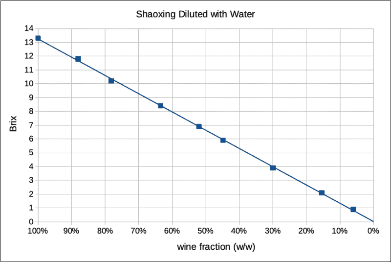

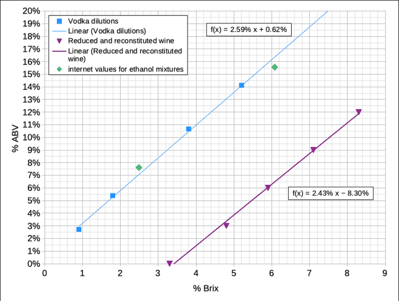

I did another experiment this morning. I did a few things actually.
First I measured vodka at a few different dilutions with my refractometer, just as a consistency check. The data lined up with the numbers I found on the internet.
Then I opened an old 750ml bottle of red wine (14.4%). I measured it with my refractometer: 8.4% Brix. Then I sealed some in a small jar and put it in boiling water for an hour. I wanted to see if simply heating the wine would change the refractive properties. It didn't.
At the same time I took the remaining 650ml and reduced it in a double boiler for a little over an hour, reducing it to 300ml. After cooling it I split it up into five portions, reconstituting each to the correct volume. But I didn't just use water; I also included varying measured amounts of 40% vodka. That gave me a series of samples at varying ABV. I didn't know what the values were but I knew by how much they differed. When plotted they displayed essentially the same slope as the ethanol-water (or diluted vodka) samples. And that slope is roughly 2.4% ABV/%Brix.
So I could figure out what how much my wine was reduced to. Reconstituted it was 2.3% ABV. The original reduced wine, before I added water, would have been 5.0% ABV.
Since the slope roughly matched pure (or nearly pure) ethanol-water I suspect that this is not something that will only work with the wine I chose, or even red wines in general. Probably it would work for yours as well. But I don't know that. You could always duplicate what I did this morning. Or just figure it's close enough.
View attachment 323886The cooked wines sure didn't taste that nice though. The best of the bunch was the one I added the most vodka to. That one, which was just barely shy of the original strength of the 14.4% wine, had a sweetness the others lacked.
If you sealed some of the wine in a small jar and put it in boiling water for an hour, I wouldn't expect that it would change the refractive properties. After all, it was a closed system. All evaporated components would be condensed and returned to the wine, right? And at boiling temperature, I wouldn't expect anything flavorful.

I wasn't sure. I thought that it was possible that there were chemical changes in cooked wine that might matter. I figured I had to eliminate that variable.
As for the taste, what's the difference between 80°C and 100°C? Both of those are hot enough to drive off aromatics and probably induce other changes in the wine. The wine I reduced in a double boiler stayed within the range 65-85°C. It didn't taste very good either. Flat, dull, and sour. Undrinkable as a beverage.
Maybe in the context of cooking it doesn't matter. I don't know. I was taught to never cook with wine I wouldn't be happy to drink. But it probably depends. Wine added to a dish that simmers for an hour -- what's the difference? But if you're adding a very aromatic wine in the last seconds of a stir-fry then heating it for tens of minutes prior might ruin it.

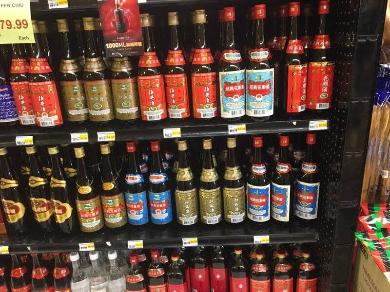

I went to Japanese markets in Berkeley, San Mateo, and Japantown in San Francisco, as well as a Korean market and a couple generic Asian places. No dice! I did find it online for $42 but decided that was too much for something I might not even like.
Thanks for the heads up about the salted version of Shaoxing. They do that with other wines too and I avoid them. Mediocre wine plus a denaturant isn't a tasty combo even for cooking.

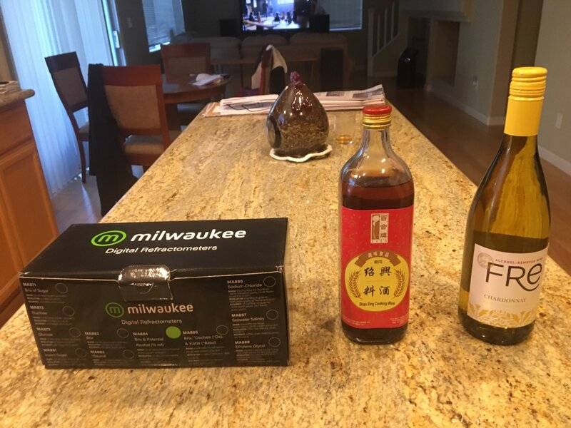

Wow, sounds like you made the whirlwind tour today! And returned empty handed? What specifically couldn't you find? The potable Shaoxing?

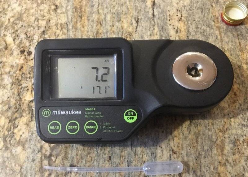

I did receive the replacement refractometer - just tried it. in cal mode read 0.0 with the supplied distilled water. With the Shaoxing it read 4.0 on the PA scale. Adding a drop of water to the Shaoxing sample, reading was 1.4. Doesn't look promising. :-(
  • #112
PAllen said:
Eden Mirin is readily available in Whole Foods. It is product of Japan, with ingredients water, rice, sea salt, Koji (aspergillus) and nothing else. It is traditionally brewed. Unfortunately, it does have salt.
Thanks for that. Whole Foods, for better or worse, is my closest supermarket so I go there often. I'm pretty sure I looked at what they had. And from what I've read, right or wrong, Hon Mirin should be at 14% alcohol and contain no salt. So even though it's fermented I would have rejected the Eden product based on that. Maybe I should give it another look since it's what's available.
  • #113

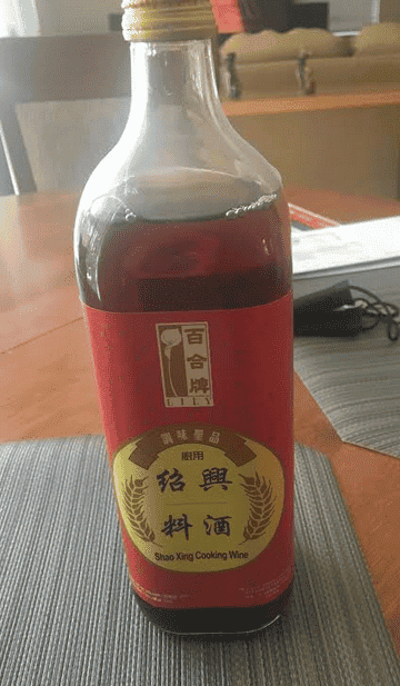

Last year I searched for a couple of months, looking for true Mirin. Like a mirage....I just got back from buying a bottle of Shaoxing wine. One of our local Asian markets was boarded up! It was always kind of a sleazy place, VERY fishy stinky, horrible music playing, dead-eyed drone cashiers. But it had been like that forever. I figured it would be always be. Nope. Gone.
So I went to the nearest alternative, a better place actually. I chose the most expensive bottle which was just $8. Tasting it, looking at it, it's interesting. Very deep yellow, almost brown. A little sweet but also another set of flavors that I know but don't have enough words to describe. Savory, unami, but more than just that. I wish my tongue and taste buds could talk. They know. I can see why it would be a valuable addition to food. I'm most certainly going to be adding it to my next stir-fry.

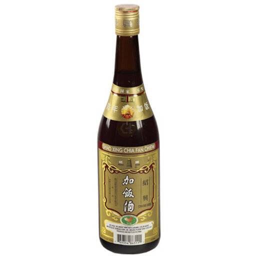

FWIW this is what I got. Is it a good one?
SHAO XING CHIA FAN CHIEW
PAGODA BRAND
ALC. 17% BY VOL
82% RICE, 18% WHEAT, WINE WITH CARAMEL COLOR ADDED
PRODUCED AND BOTTLED IN CHINA

Obviously, no salt and meant for possible drinking would be better (the Eden has only 10% alcohol). But it sure seems a lot better than what you were describing. I’ve found it quite nice in cooking, but I am no expert.

I'm not exactly sure what you ended up with today. This is my bottle of Shaoxing:
Nearly all the bottles of the cooking variety have red and gold labels. Smells good but I wouldn't drink it.

Yours says "cooking wine". Does that mean it has salt added?
I wonder what's up with your refractometer? It's 5X the price I paid, you'd think it would work better. I'm not sure what you were hoping to achieve by measuring dilutions though. Wouldn't you expect a straight line heading toward zero? That's what I imagined would happen.
I tried it with the wine I bought and, yes, that's exactly what I got:
View attachment 324048By the way, the Washington Post recently published a timely article on the subject of dealcoholized wines. Maybe it won't be that much longer before you can just go and buy a reduced alcohol Shaoxing.
https://www.washingtonpost.com/business/2023/03/25/nonalcoholic-wine/
Yes, my Shaoxing has 1.5% salt added; not potable. Geez, your chart is exactly what I expect though you are plotting Brix against wine fraction not PA against wine fraction. I will need to experiment more with my refractometer; didn't try it yesterday on the Brix scale.
Thanks for the WP article. Sounds like wine is the toughest non-alcoholic nut to crack. I received a coupon yesterday from Total Wine. I may take a jaunt over and see what they have in the way of low alcohol and non-alcoholic wines and get a bottle.
I don't know why you are using PA. You don't know what it means. There are numerous models for estimating the alcohol produced from grape juice with a given sugar content. There are simple models that are just a conversion factor, like PA = 0.55 * Brix. Others try to take into account that there will be residual sugar and other unfermentables that affect the refractometer (or hydrometer) measurement. So then you get something like PA = 0.55 * Brix - 3, or whatever. Who knows what your refractometer is doing. And, more to the point, why do you care when you're not trying to estimate the potential alcohol of a sugar solution?
  • #120
OK, good point. Didn't have time to look at this today. The day today was devoted to another chemical problem, reducing the pungency of chopped fresh garlic in sauces for my wife's business. I mention this only in passing since I don't alert and get barked at by the Forum moderation police.
You are right, there's no way of knowing what the Brix to PA calculation the refractometer is using. I wonder if repeating your Brix against dilution advances my cause? I'm still tempted to drag the sous vide bath back out and perform a reduction in volume at a very controlled temperature measuring the Brix at controlled time points. Maybe reconstitute back to full volume at each Brix measurement point? Also, can taste the reconstituted wine at each test time compared to the full ABV wine.
